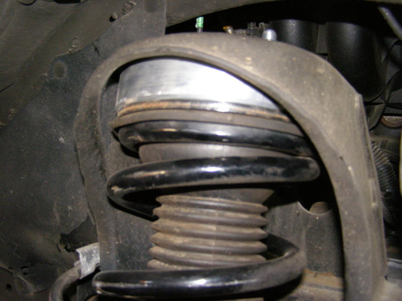

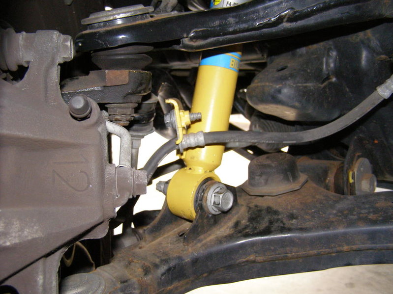

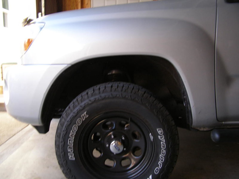

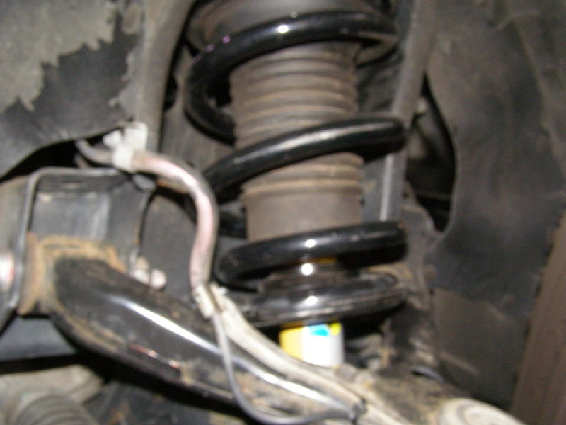

  6. May 23, 2012 at 5:05 PM
    Blackcat10
    Blackcat10 [OP] Well-Known Member
    Mar 15, 2011
    #53069
    88
    Here are the pic's Truck is on the ground. The struts are the ones listed for the truck.
