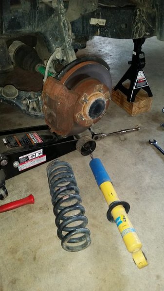

    Worked like a champ, but I was afraid as hell.

    This is the method I used, except on my 03' there is 4 bolts holding the lower ball joint to the knuckle. Be sure and loctite and torque those back and snug control arms but don't tighten until weight is on the wheels.
