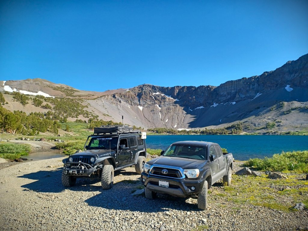

    I installed the 5100s, front and back. Last week we took it to Leavitt Lake off of Sonora Pass. Thank you for all the information and feedback. Did not mess with the sway bar. Leavitt Lake.jpg
