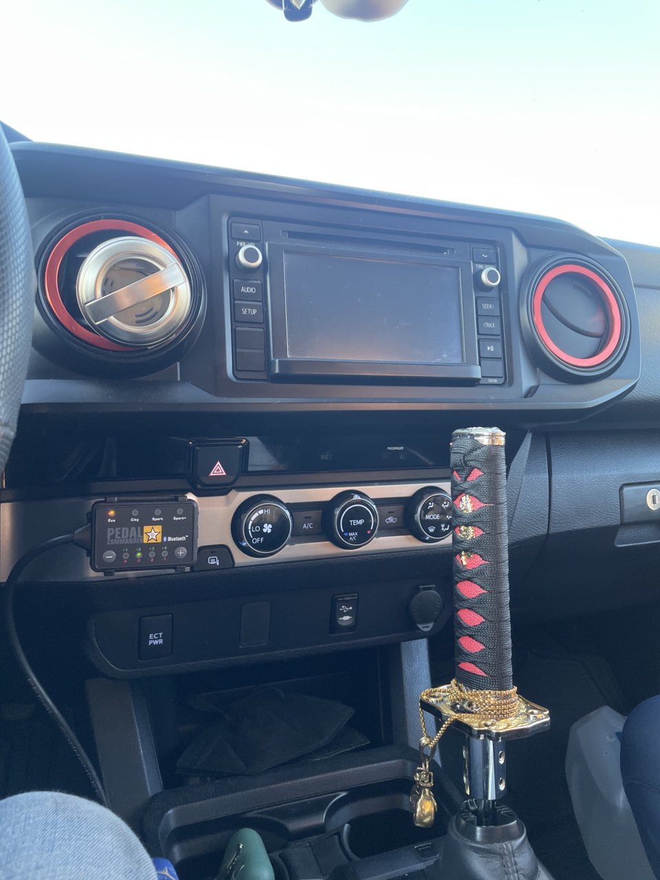

    I just bought this new unit on eBay pictured below, is this plug and play with my current stereos wiring? Didn’t realize they weren’t including its wiring. I am also aware of the bezel thank you!

    Oh look, another mod....
    Is that..a samurai sword handle shifter? Man, you Tacoma guys are fucking crazy with your mod's sometimes. Haha

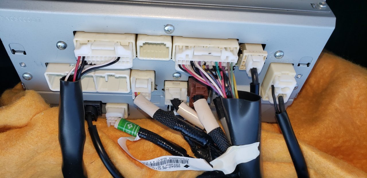

    Tough to tell in my photo but there are couple jumpers from the bottom module to the head unit. As long as the unit is non-JBL then the audio portion of the unit, minus the Sirius processor will be plug and play.

    Your trucks harness is plug and play, but there are a few jumper wires that go from the bottom box to the top box. This is just for the XM radio and are not needed to make the rest of the radio work
