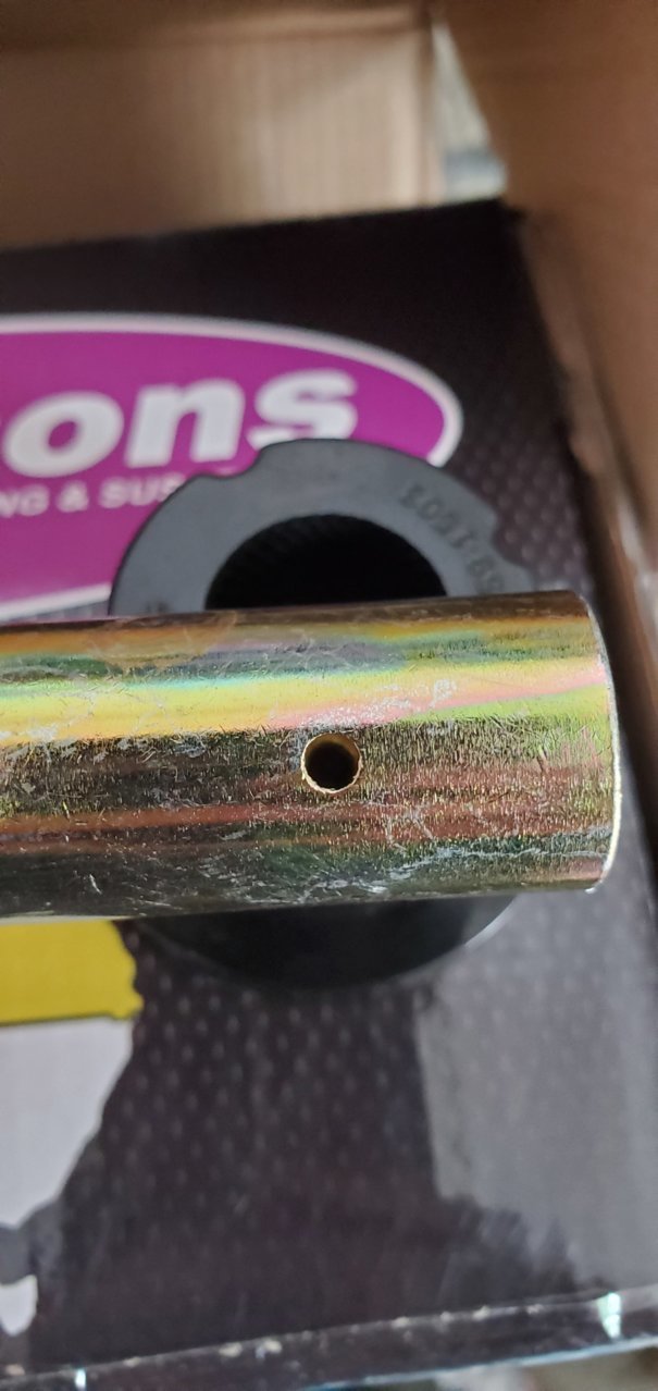

    FYI the Dobinsons leaf bushing sleeves are tapped. I didn't buy their greasable bolts.20200526_130630.jpg
    Overall the Heavy 111r leaf pack is holding up great, quite, and maintaining ample 2.5+" lift with close to 525lbs (counting hardshell and edc)
