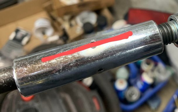

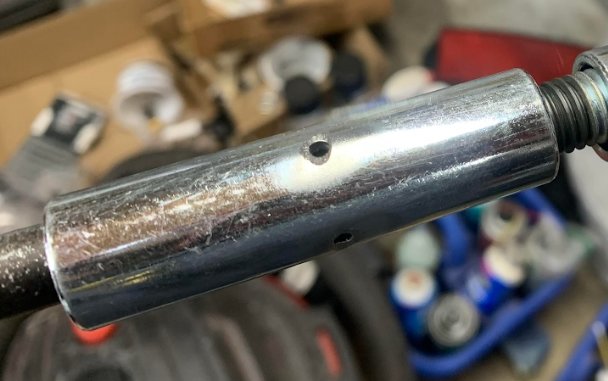

    Check out the inside of your poly bushings - you might find that they already have grooves in them. The ones that came with my Alcan springs did have grooves, so only holes had to be drilled. Until the grease can get between the poly bushing and the metal bushing sleeve via holes, the greaseable bolts are only acting as bolts, and any grease pumped in merely fills the void. Grooves in the metal sleeve would be overkill, and would likely act as a cheese grater on the poly bush material. Definitely want to keep those smooth.
    Image:
    * After this image was taken, I spritzed them with a moly-disulfide film (basically paint) to help start them out nice and slippery.
    ** If I did this project again, I would not cross-drill in the center again -- instead, I would cross drill 1/3 of the way in from both ends. The center-line is where the poly bush comes together, and so grease likes to come out there, rather than penetrate out to the ends. It would be best if grease came out dead-center of the poly bushings so it can't escape easily.
    A machine shop will certainly be able to drill the holes, but guessing at a machine shop price. I did it at home with a drill, drill press adapter (cheap tool), and added some extra credit with a bench grinder with a wire wheel attached to smooth out the holes.
