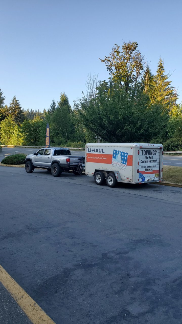

    Just pulled a 5x8, 300 miles last weekend. Houston to Dallas so pretty flat. The Uhaul was about 1/2 full with furniture. Held it right at 70. Didnt even know it was back there. 13.7 MPG though. 2022 OR with Sumo springs.

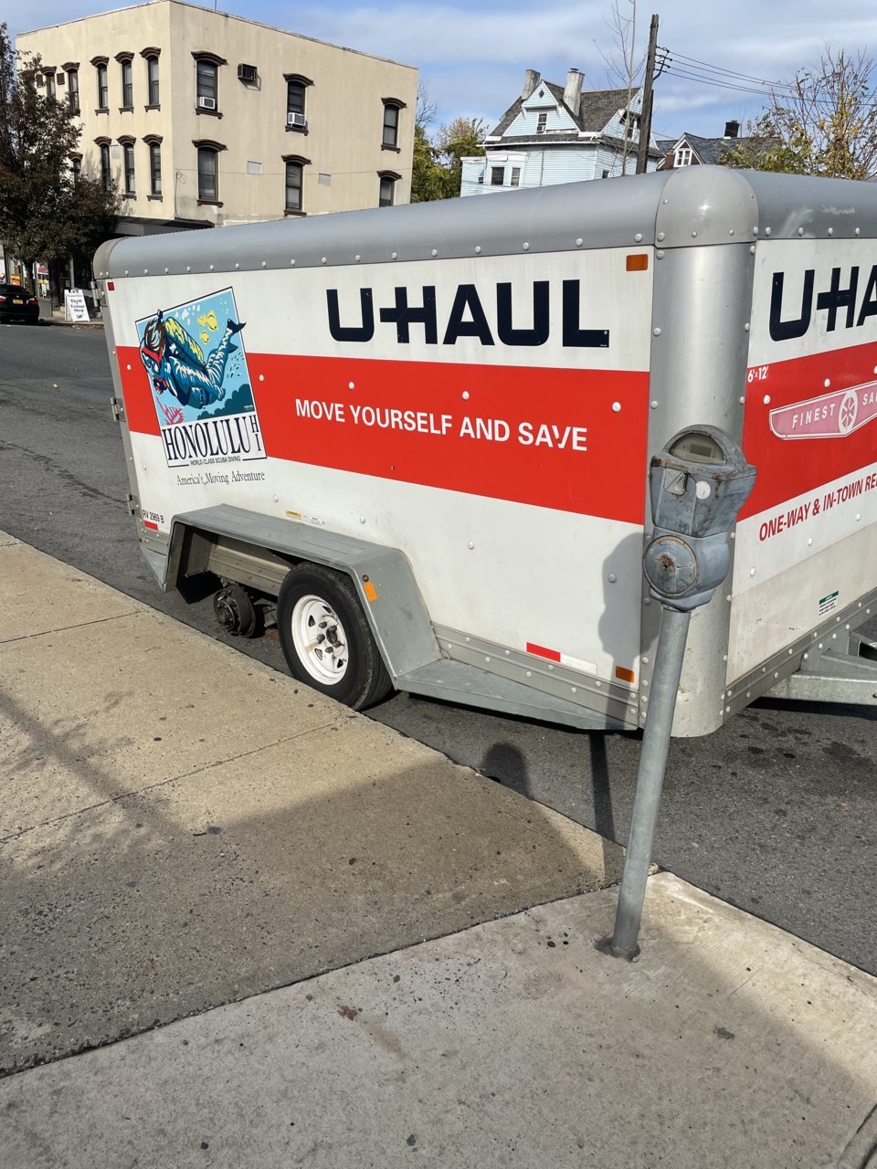

    Fully loaded with zero problems. Except the wheel that fell off the trailer going down the highway. Maybe give it a once over before accepting it lol. Took this one from NY to SC.

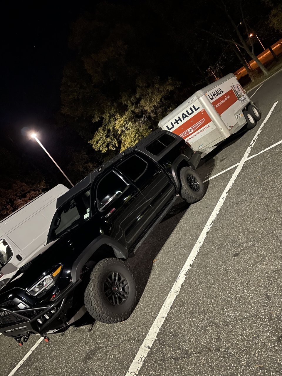

    Just towed a loaded 6 x 12 dual axle enclosed U Haul from NY to FL with a our BMW X5. It was fine up to 70 but a bit squirrelly beyond 72. I got brake checked by a NC State cop @ 2 AM going north of 70

    Ha!! It cost me $800 to rent that piece of shit and spent 3 hours in the Bronx getting a new trailer and having all my shit moved from one to the other. They did not budge when I asked for a discount

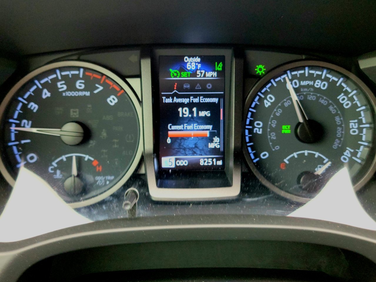

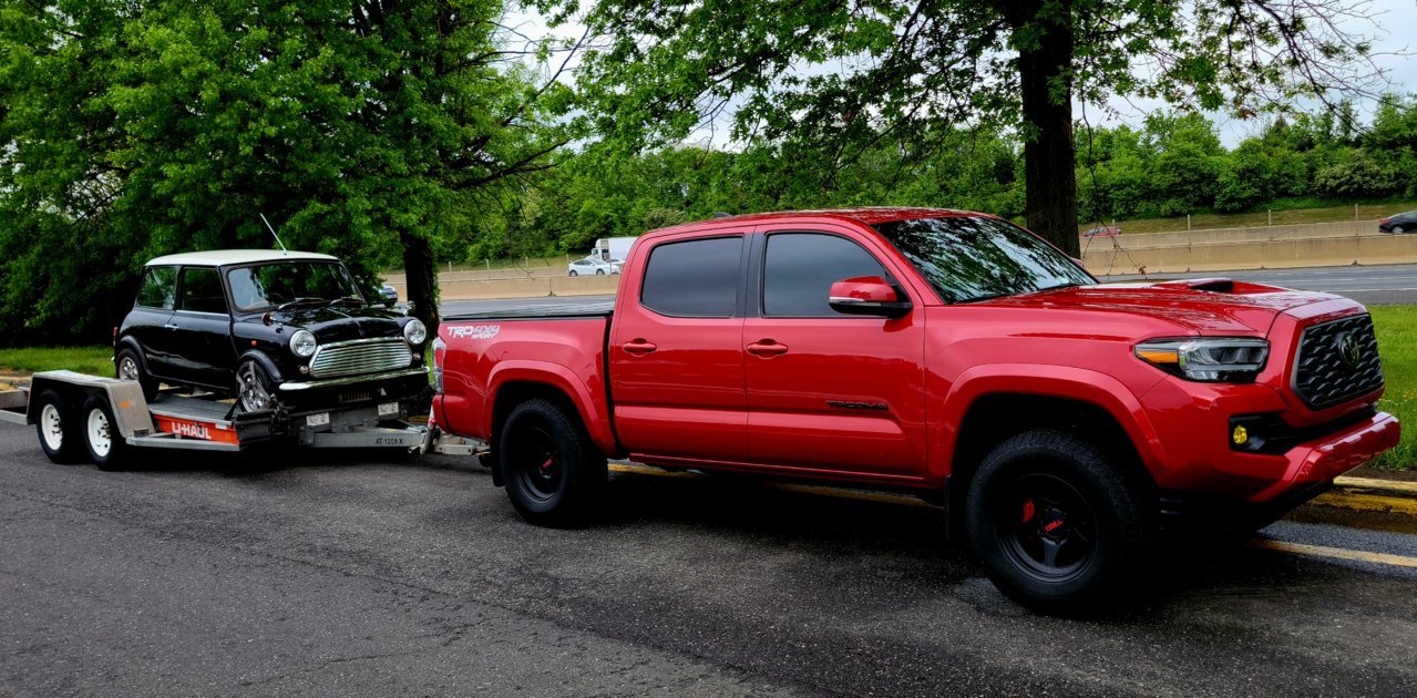

    Just finished towing a Classic MINI on a U-HAUL car carrier and was astounded with the fuel economy. The trip was about 500 miles. Trailer weighed 2,200 pounds. Classic MINI weighs 1,500 pounds. Towing this I average between 19 and 20 MPG. I expected between 12-15 MPG. I did limit my speed to 55 MPH. Also running 19 pound FN Wheels on 245/75/16 tires. Very happy with this.
