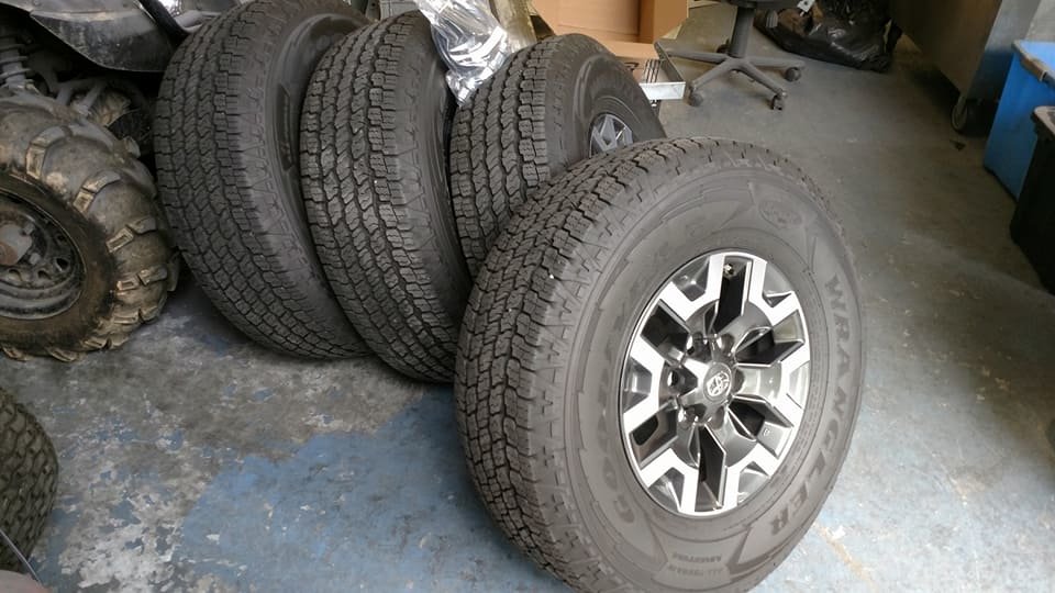

    I have acquired a set of TRD Off-Road wheels with new tires on them. I plan to move the tires and TPMS sensors onto a set of TRD Beadlocks. Will the TPMS sensors from the Off-Road tires fit in the beadlocks? Also, will TPMS sensors from a 2016/17 Off-Road truck communicate with a 2007 truck?
