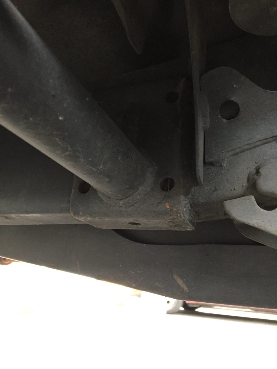

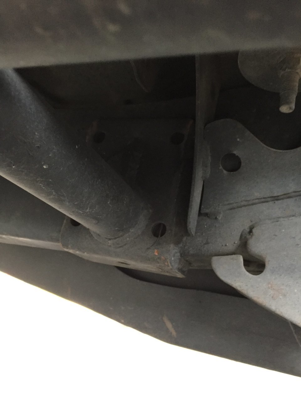

    So I'm wondering if you guys center your sliders with the same amount of distance between the front and rear fenders? Or a little bit forward or rear? The trail gear slider rear scab plate has a bit of a gap where the rear frame starts to turn up at the leaf spring hanger. It looks like I have to move them forward to have a flat surface to weld to.

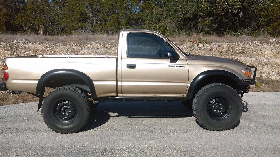

    image.jpg IIRC I lined up the front of the tube with the front fender bolt.

    ^^^^ damn that's an awesome looking reg cab!
    We centered them and then looked at where the scab plates sit for welding. I think we did bump them forward a bit to avoid what you are talking about.

    That the stock angle they sit at? Looks perfect.

    Thanks, I'll just slide them forward until I get to the flat spot on the frame. BTW these sliders are very nicely put together for the price. The welds are beautiful. Very happy with the quality so far.

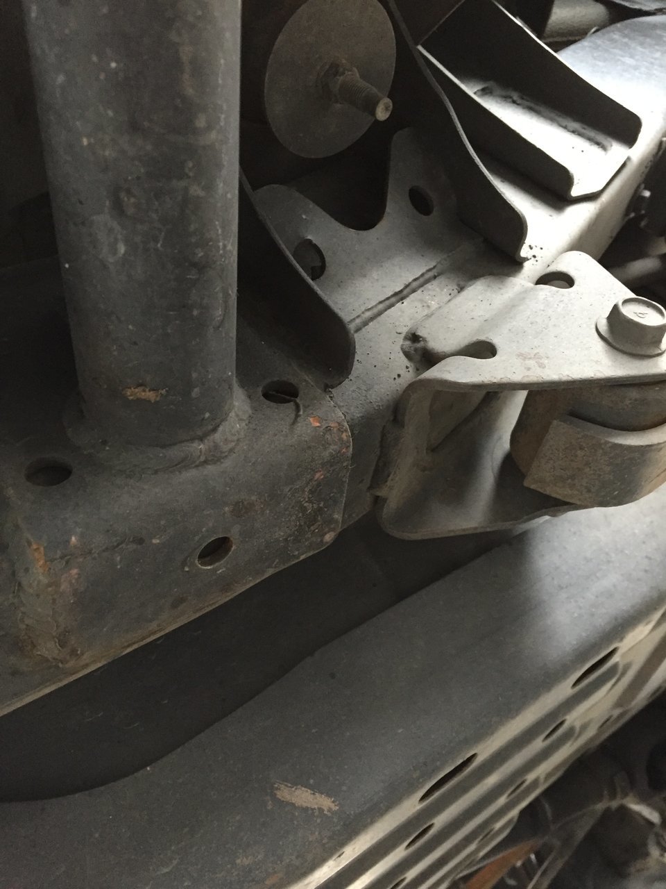

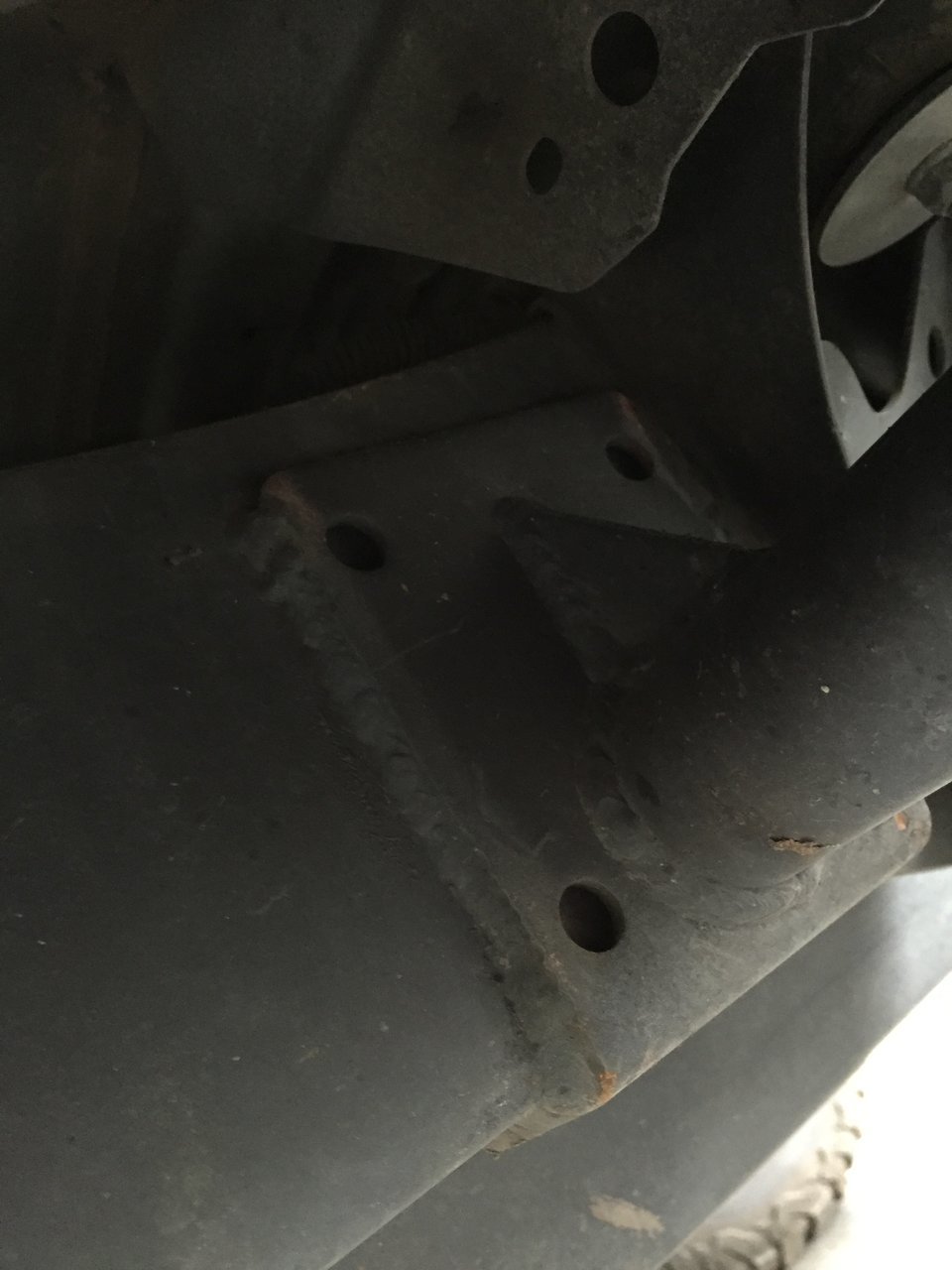

    20171222_191109.jpg These ones come pre assembled with plates and gussets already welded to the legs. Just fit and weld to the frame.

    Yeah. They're the bolt on TG sliders right? That's how mine looked too. I ordered the bolt ones and had them welded on. I have a DC though.

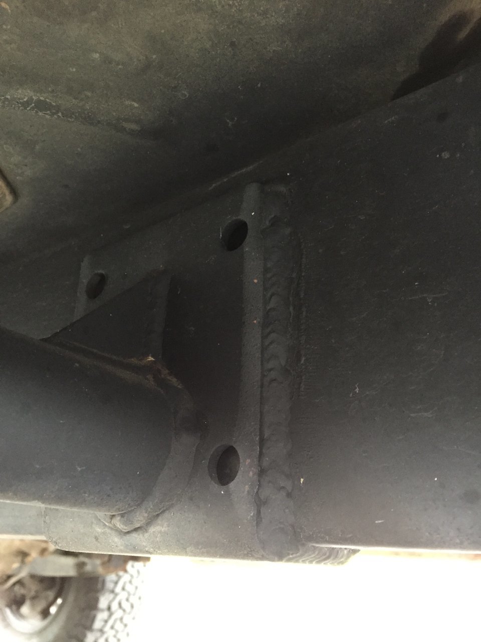

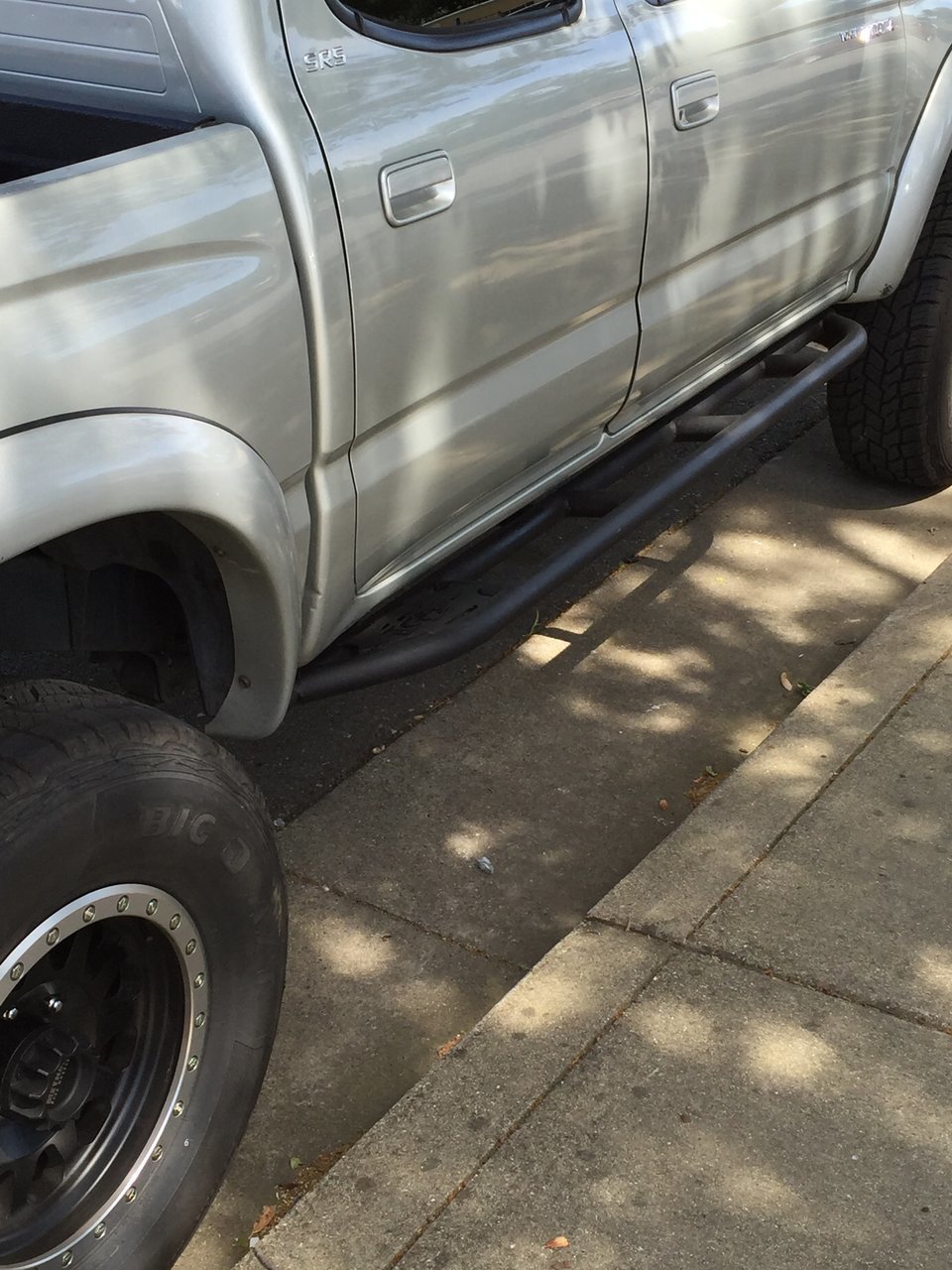

    They are the TG bolt on, but I'm going to weld them for sure. Same length as the DC for extra cab. Any pictures or the rear plate welded on? I'm just trying to get an idea of how far back people are going with these.

    Here ya go. Tried my best. The rear mount doesn't look like it's welded all the way around in the photos. But it is.

    Awsome thanks. That's exactly what I was looking for. Merry Christmas!
