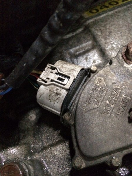

    Jimmyh, the wire inside the actual transmission - is that the transmission wire harness that I have to clean? Or is there some connections outside the transmission that I have to clean such as this one? (see picture) which is on the passenger side.

    The Cable run inside of the transmission is for the solenoids ( I think there are 7 of them ). This comes out of the transmission to a connector like is displayed in the graphic above. Into that there is a vehicle harness that plugs into it that connects to the ECU.
    Like this:
    Solenoids-----------Internal Transmission Cable-----|Plug on Transmission |----Wire Harness to ECU

    Just wanted to give a little update in case anybody was interested - I haven't had much time to fool around with it since last weekend but I finally found the corroded plug (not the one in the picture i posted earlier) I have two pins broke off due to corrosion on the transmission male connector, so I will need a new transmission wire. I checked with Toyota again and they said I should also replace the female plug from the main engine wiring harness, or just replace the entire engine wiring harness but they could get really expensive. I wish i didn't have to touch the engine harness but they think the corrosion will continue to seep down into a new transmission cable. They also think the broken pins are still in the female connector. I will buy the transmission cable brand new and try and find a scrapped Tacoma somewhere so I can get that female plug. Wish me luck
