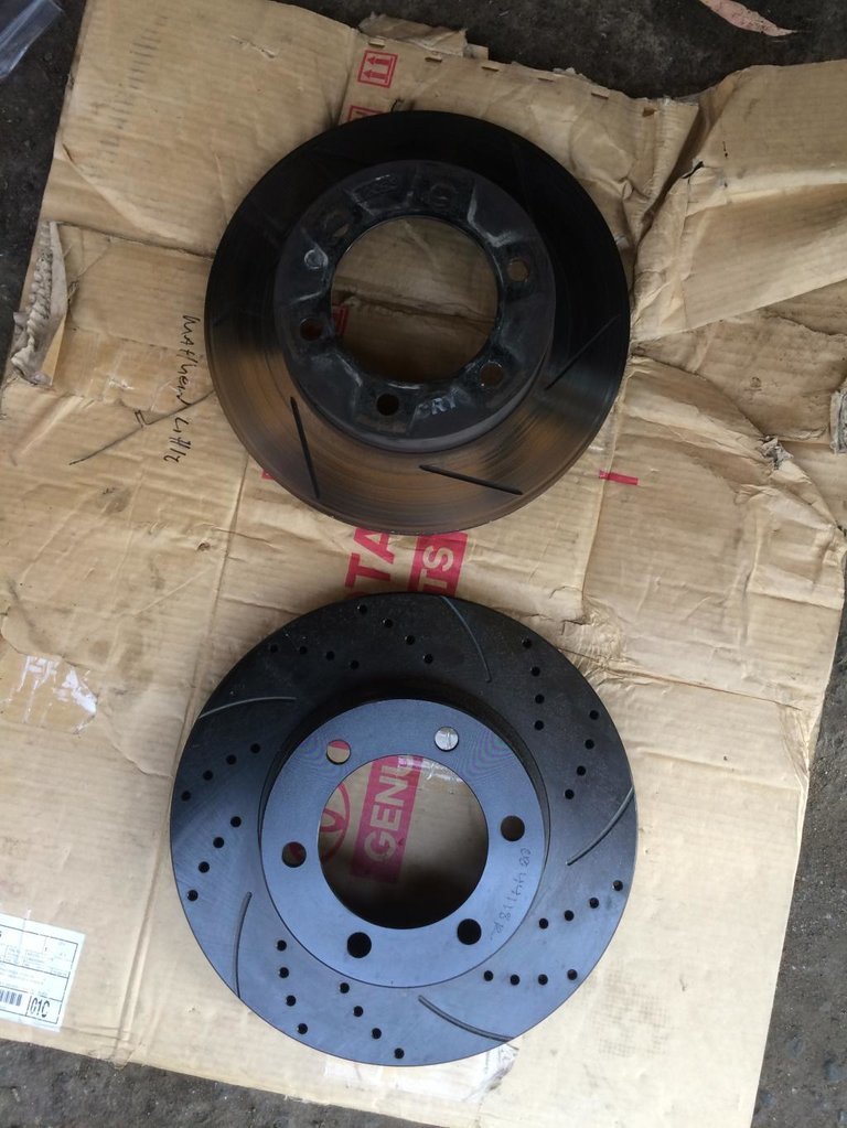

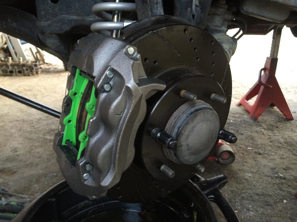

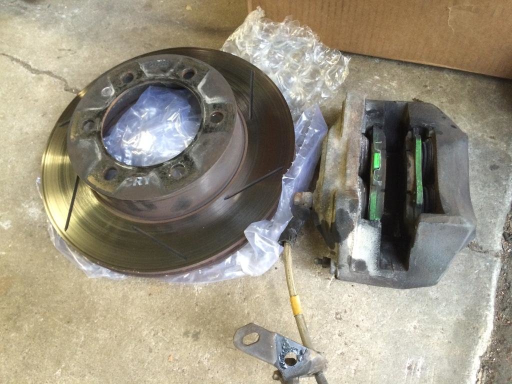

    Upgraded to the LCEngineering kit with EBC green stuff 7000k pads.
    Been on the truck around a week and still bedding in, Wow the pedal feel and reaction time with stopping power is very noticeable.
    I am heavier and taller than stock so this was a needed upgrade.
    Running 16x8 American Racing Chamber Teflons with a decent amount of room for caliper clearance.
    Old vs New:
    045092C6-28D7-4887-AFE2-E31BA7F04094_zps_63d3e09c16cb087bf95fb44c2cd4bb20e38941da.jpg
    27154CBA-FF4E-4C7C-BCA4-2BADF3D85717_zps_401bf1d39dc1dd291151237ae47cee42597ad582.jpg
    New stuff installed:
    0AEA265B-6D0C-4639-9B78-6B6882B6F18B_zps_73eb10636ad6ba5ace02f24eb524004e7d47cd46.jpg
