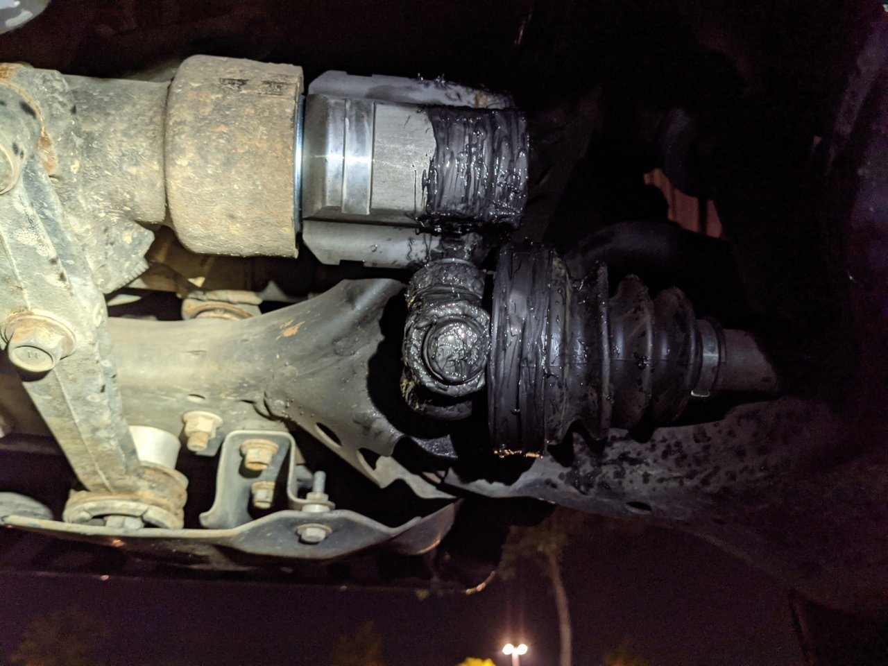

    This is what happens when you take very sharp turns while forcing it as it binds. Pic was taken from my passenger side CV axle shaft by the way. It popped. Always put it back onto 2H when you have to make tight turns. Learn from my mistake.

    If you have a healthy driveline then this should not happen.

    How do you think the driveline gets "not healthy". Don't drive on surfaces with high traction in 4X4.

    No, Poor Maintenance or crap parts is the cause of what I would consider "unhealthy"
    fear of breaking parts while binding your driveline while otherwise well maintained is unfounded.

    i do 4wd donuts on dry payment and haven't busted a cv. Yall just got weak parts.

    Seriously though, I cant help but laugh at this thread and all the "dont do it on pavement blah blah blah". Its fine, and if you're worried about breaking stuff on dry pavement, better throw the truck away :rofl:I have buddies that run 38-40" tires on the rocks, and its pretty rare that they break something unless they are rock bouncing.
