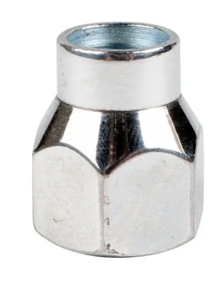

  15. Mar 13, 2022 at 3:45 PM

  17. Mar 13, 2022 at 4:35 PM
    #37
    LunarRockV
    LunarRockV [OP] Well-Known Member
    Dec 30, 2021
    #385888
    480
    Kyle
    2022 Lunar Rock SR5 Trail Tacoma
    Why do you say at least up front? And would those not come with the spacers?
  18. Mar 13, 2022 at 4:47 PM
    #38
    Dalandser
    Dalandser ¡Me Gustan Las Tacos-mas!
    Feb 19, 2015
    #149090
    17,626
    Anthony
    Downey
    08 PreRunner Regular Cab / 98 4x4 Extra Cab
    Empty Wallet Mod
    Unless they made a change, front studs have less stickout. I don't know what you bought, these lug nuts use the collar to give your more engagement.
