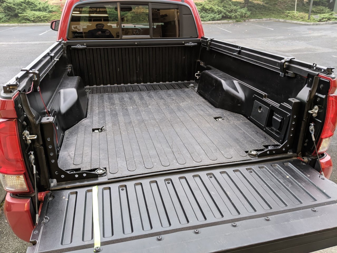

    Hey
    Lastnight i removed the bed storage that came with my truck. There are a couple threaded holes that i assume will take a tie down/D ring. what is the part number for those? pic to help explain[​IMG]

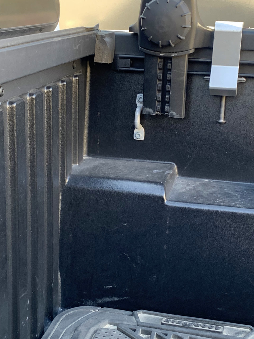

    On non-Trail Edition Tacos, there is a hoop there, like you can see in my pic. SBs, it is where you are showing. LBs have it in front of the wheel well.
    The only thing you want to be sure about is that there is a metal backing plate for some strength. I would guess that it is there, but it would be good to check.

    Oh! If it was used for attaching the storage boxes, then the backing plate should be there.
    I am sorry, but my account is broken at toyota.com. So, parts lookups are not working for me.
    That loop is definitely handy for light loads. If you're tying something down, like a motorcycle, D rings on the bed bolts are the better way to go.

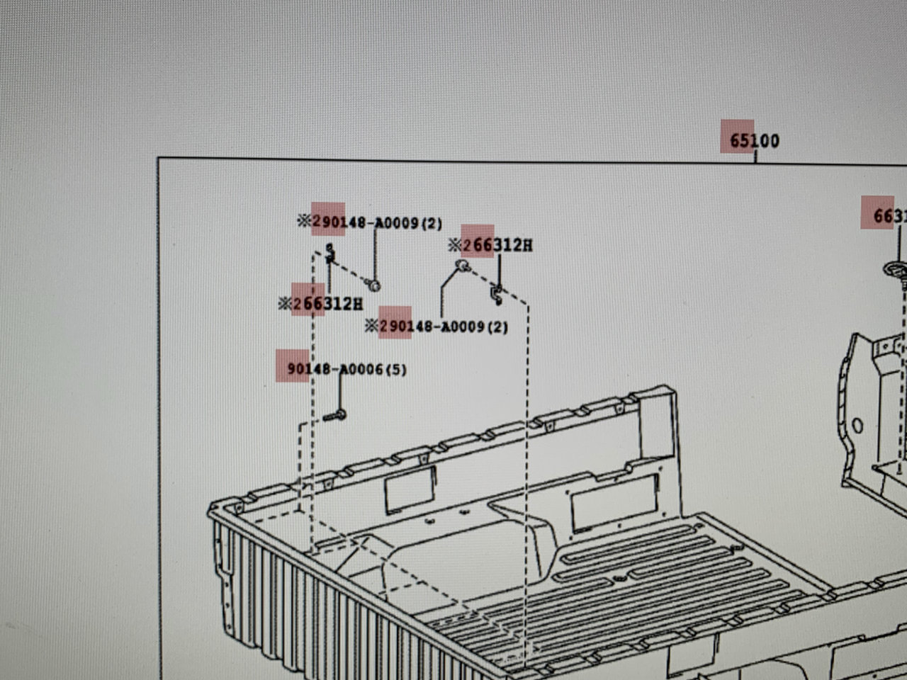

    still researching...

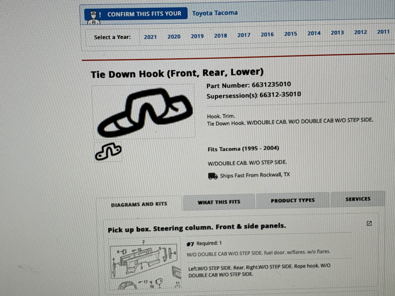

    worst doodle of all time. wtf
    also, you are the fucking man. thank you for the assist. my shopping list keeps getting longer.

    That tie down is crawling away. If you use that one, after a couple of weeks, it makes a chrysalis and turns into a butterfly

    So $25 for the OEM Part or $50 for the pair?
    I’ll sell my pair for $25 shipped if you want. I’d have a hard time paying $50 for them.

    I wouldn't use them for a high load. If you're going to be tying down something heavy add rings of your choice to the bed bolts in the front. Save those for lighter stuff.
    Edit: You can see the added rings in tonereds pic.

    That is a good idea as the more tie downs the better, but what @RX1cobra was getting at is the ones in my pic are on the bed bolts that attach to the truck frame. The best connection that we got for tiedowns.
    My concern here is similar to your missing loops. The composite bed is strong, but limited.
