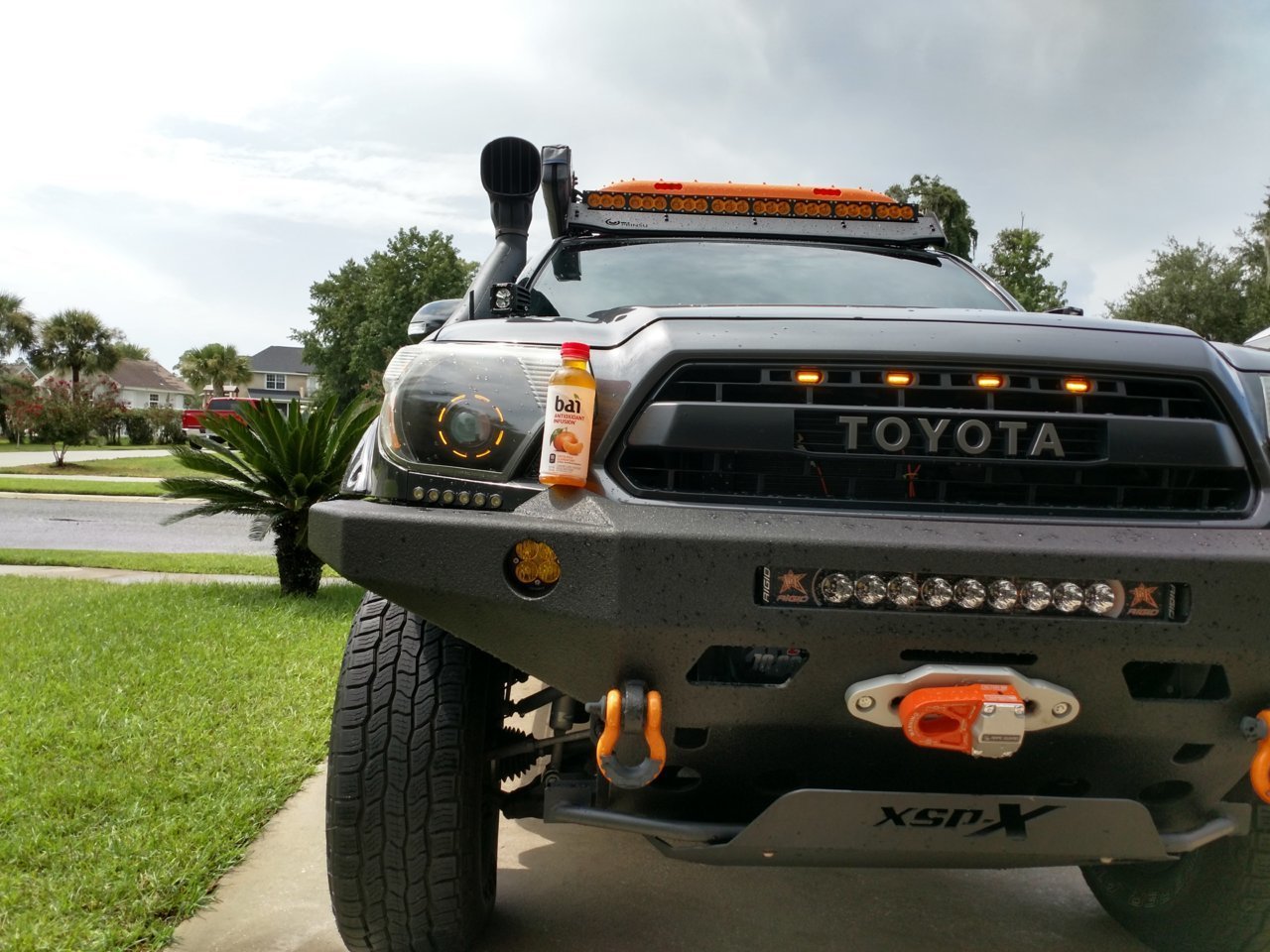

    I have a Pelfreybilt aluminum bumper coated in Line-X. I got it used. I pulled with it once and the guy who owned it before me pulled with it a few times (Smittybilt X20 10,000). I agree that prep work is key and you shouldn't have any worries.
    I did just see an aluminum bumper with damage to the mounting plate posted for sale last week here. I didn't see any back story on what happened. Pelfrey had some talented welders for sure.
