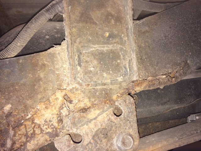

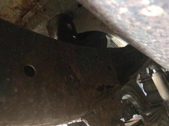

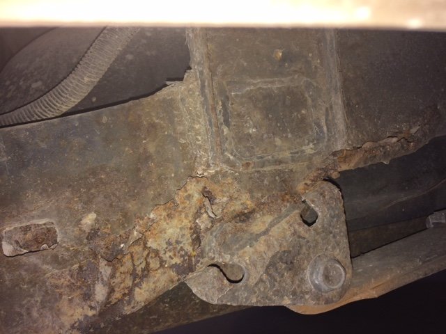

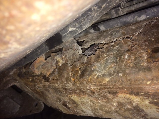

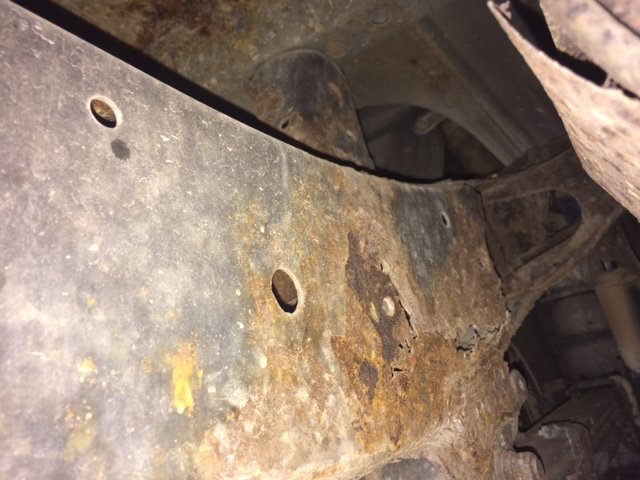

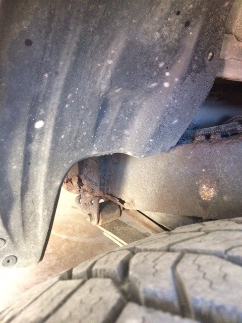

    Sorry for the delay OP...

    I don't mean to be the party pooper but she is looking pretty bad under there. I'm not sure if it would be causing the T case issues, but it will be causing others in the future. I took some leaf springs off a Taco with similar rust near that hanger and after a few good wacks it just fell off completely. So be sure to keep an eye on that.

    On the drivers side, the gap between the bed and cab are further apart than it is on the passenger side...
