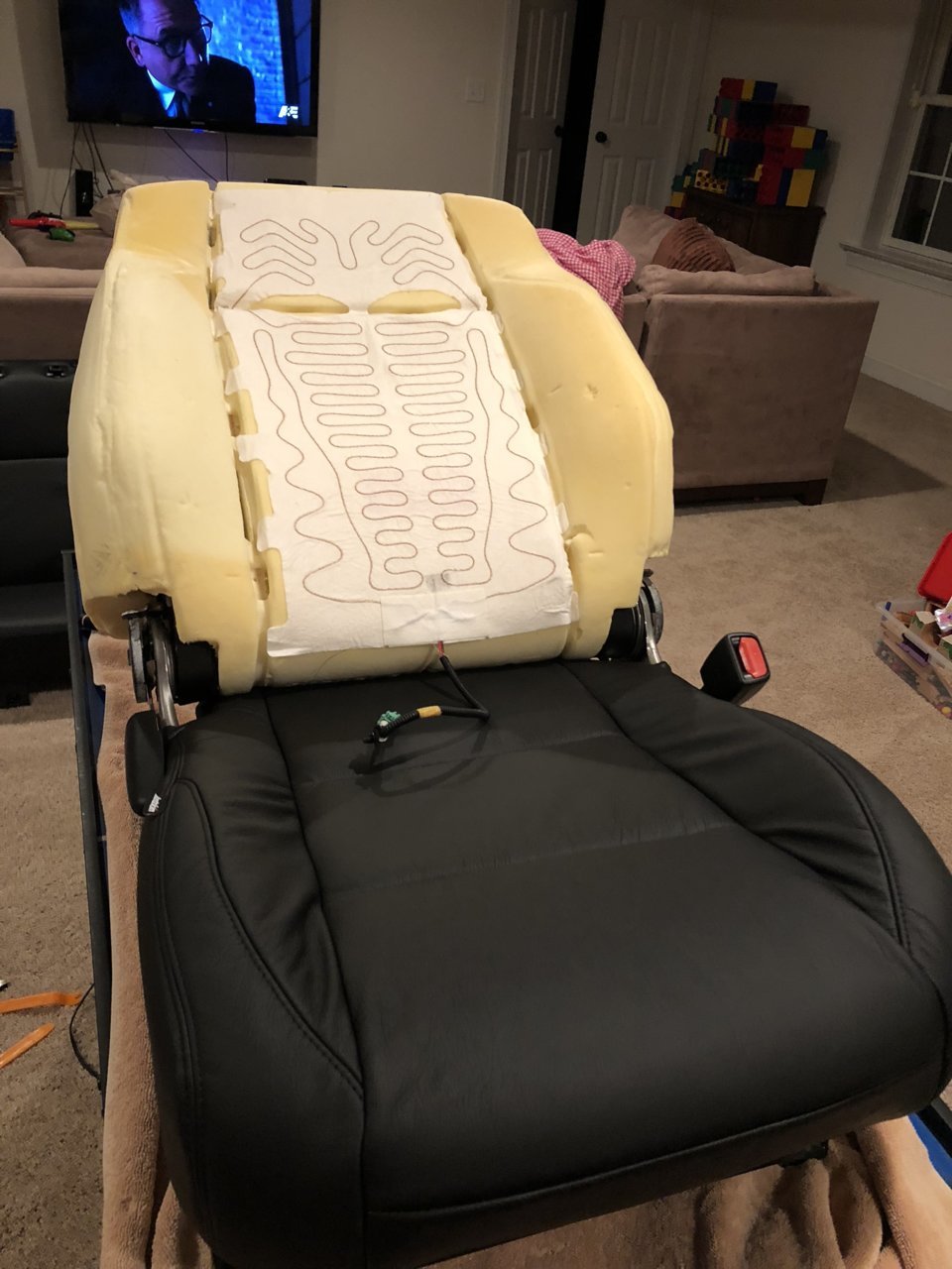

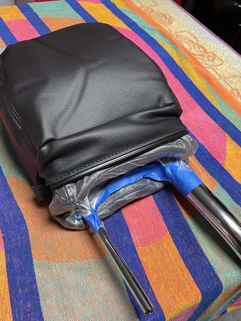

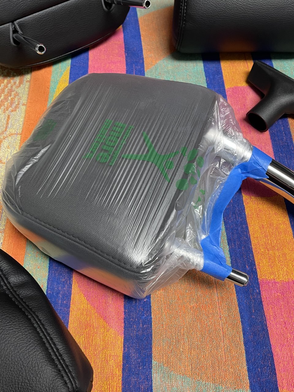

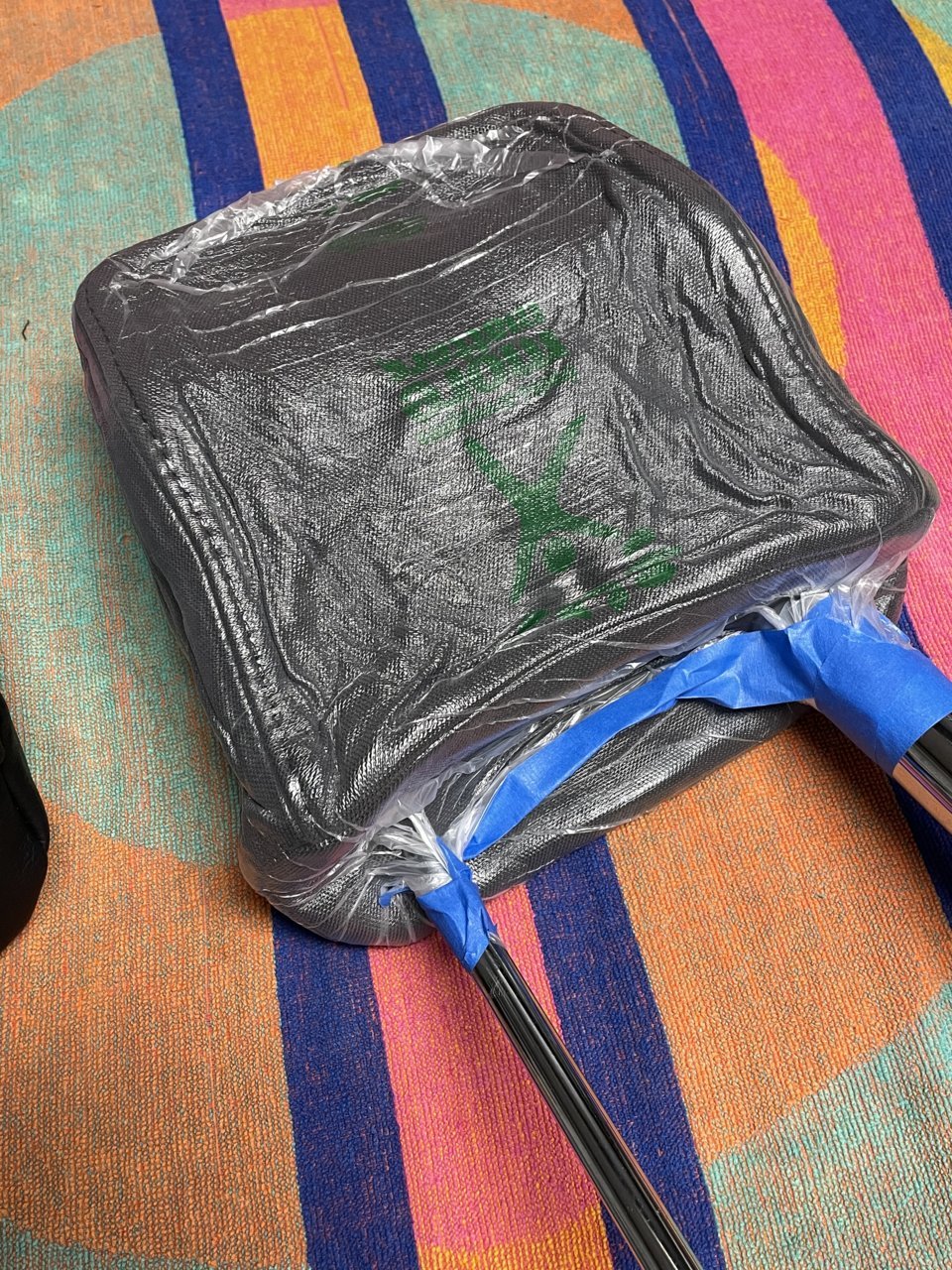

    I’ve only done the 2 front seats so far and think I’m going to hold off on the back seats Until the littles get out of car seats. I don’t want to stretch/dent the leather.
    But there are no standard seat cover straps (there is the bottom flap strap but it’s on the bottom) and use of hog ring pliers like factory. Removing the covers and installing isn’t bad at all IMO
    Tips: I found the bent handle pliers to be helpful and easy to see where I’m at in the foam. heating up the leather helps (leave in the sun or I had a space heater I’d hold in front for a couple mins). Headrests keep factory covers on and wrap in a bag, vacuum seal and slide the leather on like butter.
