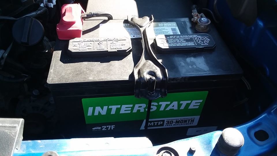

    75481848_2514378818627877_8066967485569564672_o.jpg I put a 27F in my 2016 Off Road, Just replaced the try with the right one from Toyota. Works Just Fine !!!
