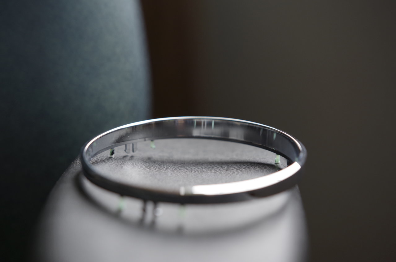

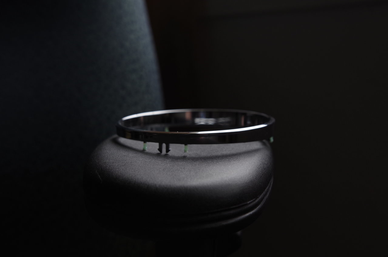

    When I take off the old chrome rings, if you pay attention you can see that the rings are not perfectly the same "depth" as you go around the ring. As well, the area that the ring pushes into is slightly "higher" on the bottom section than the top. A picture is worth a thousand words:
    You can hopefully see that as you go around the ring it gets wider and then thinner. However the Meso plastic rings are not made that way. They are evenly very thin, and you would think that they would just push into the slot and be happy. However they don't look good because they are pushed into the slot more on one side. The "low depth" area leaves the Meso ring partly sticking out higher than the surrounding cowl plastic while the opposite side of the ring gets pushed in way below the level of the plastic cowl.
    I think Meso needs to make one side bigger/thicker/wider/?? than the other as you go around the ring so it fits flat because the one side pushes way farther into the slot than the other side and it is visible. On the back of the Meso rings it has what looks like orientation markers, with 1,3,4 and a separate 2. These correspond to the vent and I think it shows the orientation of the Meso ring for installation. So I tried the 2 orientation in vent #1 but it made no difference. All four Meso rings appear identical in the package.

    both versions climate control, and non climate control have this issue. Meso even acknowledges this. the vents and rings are tapered, and difficult to duplicate. for us ocd people it hurts but, it isnt the end of the world. Ski

    Just a note, these are injection molded. If he was to make a ring special just for each vent, then the initial investment in the tooling would have cost a fortune.
