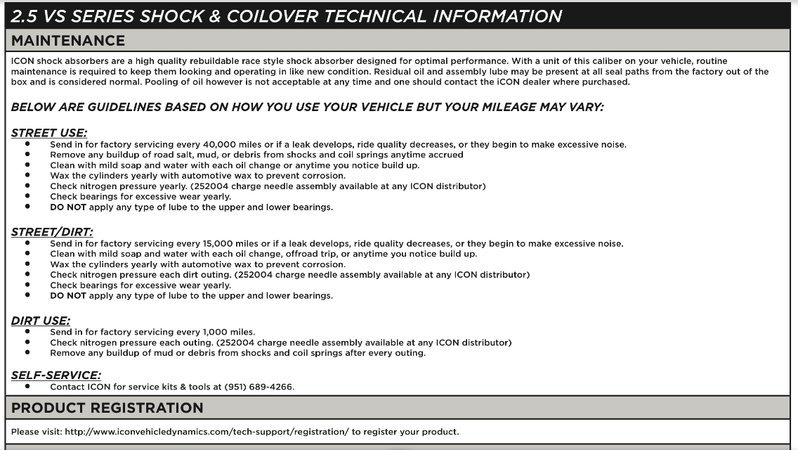

    They are likely basing that service interval off of people using them they way they were designed to be used on a regular basis (moderate to heavy off-roading). I've been in a truck running Kings and while it was amazing how well they handled flying over ruts and mounds of dirt off-road, I can see how they would need servicing after 50k miles if that was done regularly. If you only off-road on occasion then I'm sure you could push the service interval off further.

    I would hope so. What worried me was Icons recommendation of 40-50k was only street driving. Combination of street/dirt was 15k!
    I'm sure that's for optimal performance. My guess is nobody is doing that.

    Shocks have oil. The hotter you get them, the more the oil breaks down. Do you also never change your oil in your truck?
    Rebuild them yourself. It takes 30 minutes to rebuild a shock even if you don't know what you're doing.
    Nitrogen setups are only about $200 and takes no special tools other than the nitrogen regulator and tank.

    most people are overthinking their "dirt use". if you get out and wheel once or twice a month, or if you hit up some dirt trails every weekend......you're still in the street use category. if you fit the bill for the 50/50 street dirt category, it's highly likely that you're Tacoma is not your daily driver.
    in general, if you daily your Tacoma, consider it street use. if you only street drive it when you are driving to your off road location of choice or the occasional weekend stroll, street/dirt. if you trailer it to the trails, dirt only.
