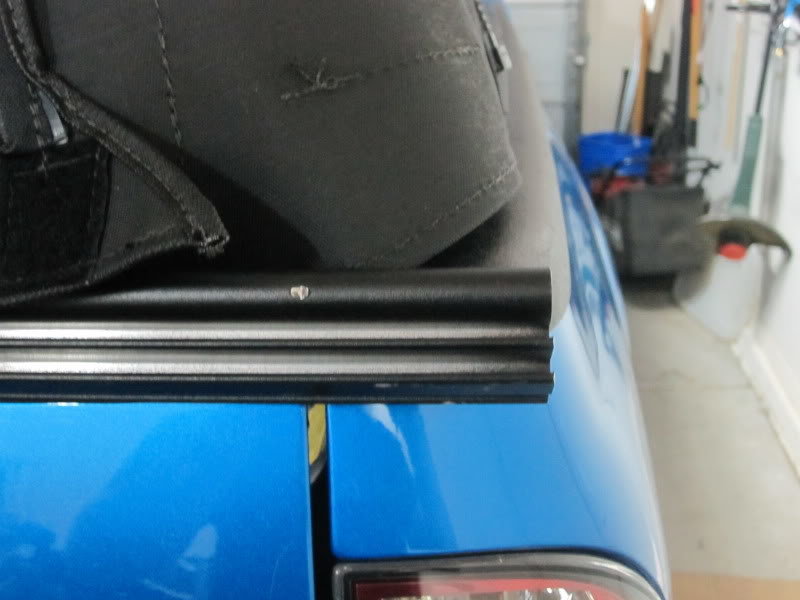

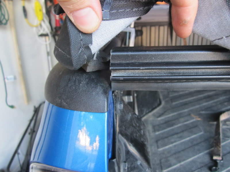

    OK, so I am just finishing up my Bestop install and I think that my tailgate bar that they sent me is too long, or I am just an idiot and cant figure it out. The total length of the bar is 62.250" which seems long seeing as how the inside measurement of the rails is 58".
    I emailed bestop but they probably wont get back to me till Monday at the earliest, so any help/suggestions would be appreciated. I am holding off sawzalling it till I can get a conformation on the length it should be :D
    Right side
    Left side
    Overall

    It does look awful long! Should only come to the center of the tail lights. They have great cutomer service so Im sure they will make it right. Best of luck!

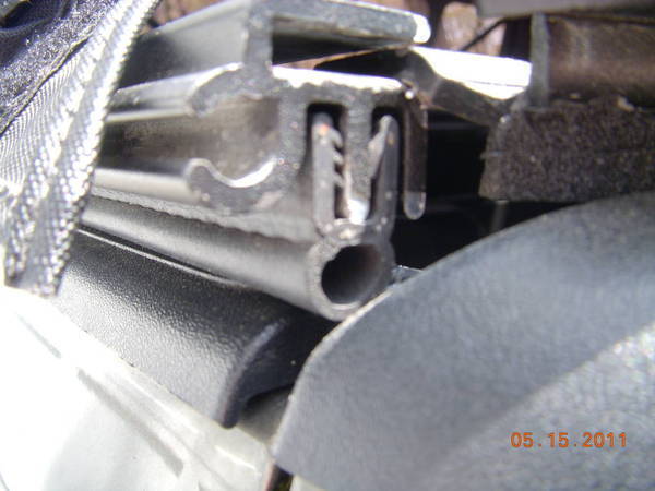

    Beth,
    I've never had that problem. To get the bar off the side tabs, I really have to tug on it. Are you absolutely sure you've got the bar installed correctly? I know I had some problems with that in the beginning. Compare it to mine in the pic below, where I've pulled the bar almost completely off the side tab to give you a better view.

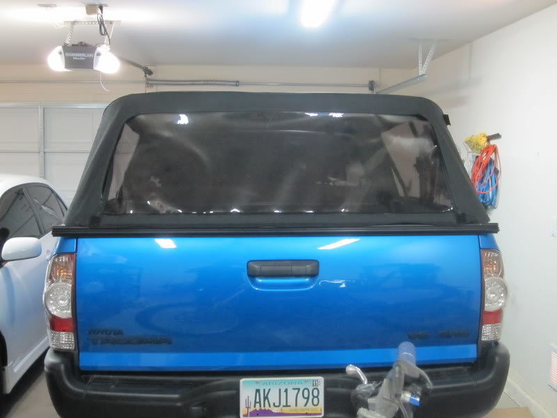

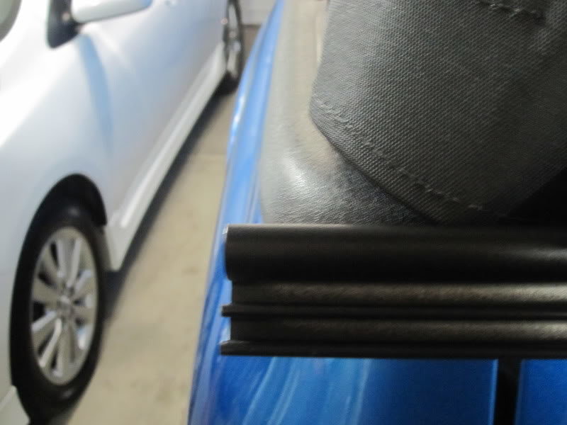

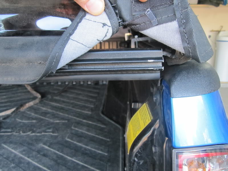

    Here is an update. Got back from Sedona about an hour ago and cut the bar to 56 1/4" and it fits perfect. The bulb gasket fits flush, and the bar fits in the track just as it should nice and snug. I can tell this is going to fit my needs perfectly.
    I will give a small review for the Bestop after using it for the first time today. I started off trip driving roughly 60miles up north to Sedona with my 2 dogs in the bed. The side windows were on and the back was rolled up, and despite heavy cross winds the top did just fine, and the dogs didnt mind one bit.
    When I got to Sedona I had someone stop with me at a gas station so they could get the manufacture of the top so they could order one for their taco as well.
    I then zipped the sides off and stored them in the back seat. Driving at speeds up to 60mph with the sides off and the back rolled up there was no problems. The dogs spent almost 3hrs total driving time, and about 45min when we went into a restaurant to eat, and didn't phase them at all. BTW the dogs are a German Shepard, and a Great Dane.
    All in all I am very impressed with this shell. Despite the one hiccup with the tailgate bar install was very straight forward, and easy. The directions could have been a touch better, and now that I think of it I should have done a write up while installing. Thanks for the help, and hopefully this thread will help someone else. :D
    New right side
    New left side
