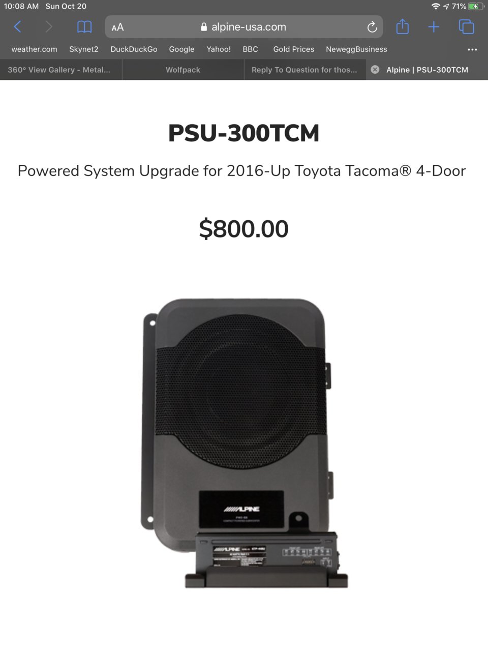

    I just put in a major upgrade on the whole Stereo.
    Went with the Kenwood Excelon DNX996XR (wireless CarPlay, Garmin maps, and three cams, and a flux capacitor:D), Maestro RR, Kenwood DRV-520 dash cam and a boyo front cam, Alpine S-S65C series component fronts, Alpine SPE-6000 series rears, and Alpine 300 psu series sub (Alpine sells one that bolts right behind your rear seat and comes with all the brackets and harness for your vehicle.
    The difference is :censored: amazing!
    It was one thing I wanted was some state of the art electronics.
    I used Crutchfield, and got all the components with no modifications or drilling.
