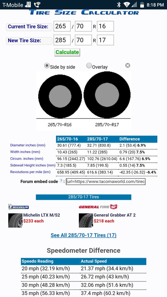

    I just switched over to 285/70/17 and it obviously has thrown off my speedo. I usually track my mileage using fuelly so how do you all do the calculations now? Or do you just say eff it

    There is a calculator in the wheels and tires section of the forums.

    You can use the calculator to see the difference in size percentage wise. For example, my tires are 4% larger than stock, so when calculating MPG, I multiply my miles traveled by 1.04 to get the true miles traveled.

    This is what I was looking for thank you based on the calculator I'm 6.9% bigger than stock so when I fill up I'll likely my mileage traveled by 1.069.
