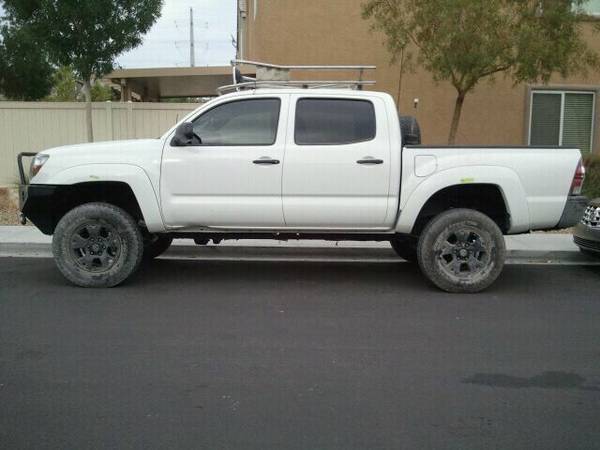

    Pretty close to factory rake. I have 885 set at 0.85 on my billies and a 2" aal on tsb leafs.
    Keep in mind I have the bumper weighing the front down a lil.
