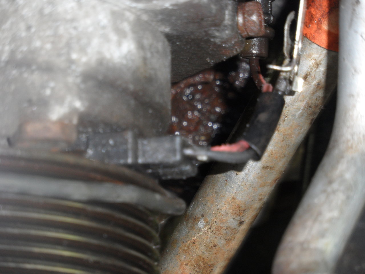

    how do i get this final electrical connect off of my ac compressor? does anyone have a diagram of this connector species?
    thank you

    Push the tab in and it will release. Sometimes what I’ve found helpful to get stubborn ones apart is to push the tab and push in the connector first then remove it.

    I didnt even see that tab until i looked at the photo i made. Thanks man.
