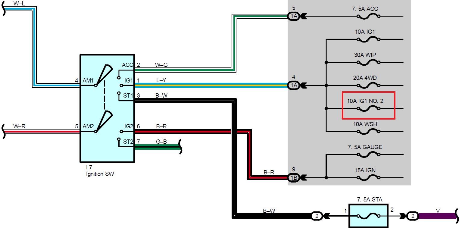

    Keyed hotwire underhood

    Huh?

    OP is confused on wording, and you are helping it go down hill...:D:burp:
