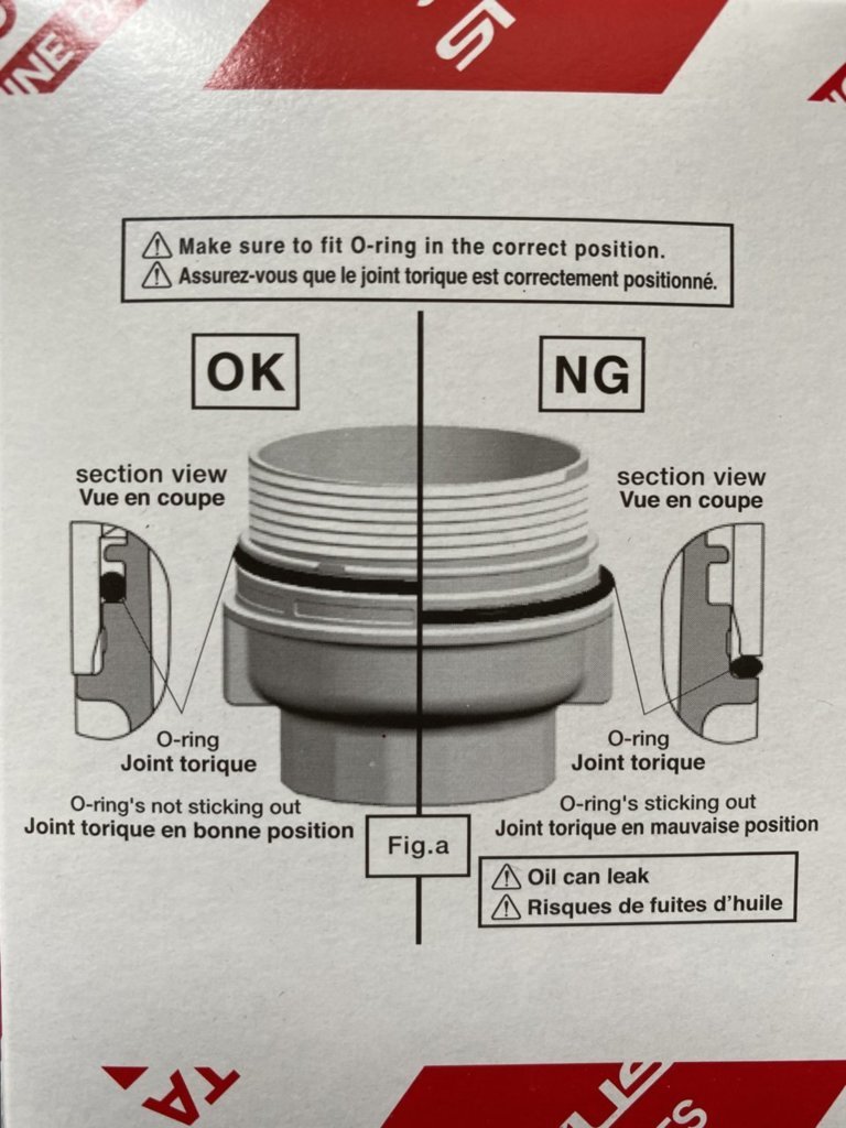

    Actually this was going to be my next question. All the videos I’ve watched don’t really show where the O-Ring goes in a very detailed manner. So in the image above the left hand side is the proper way to seat the O Ring?

    Yes.

    NG is means Not Good. You will see this in place of a crossed out circle in some places.

    The big O-ring on the housing can pull out without you seeing that. Apply a finger-coat of oil to the outside of the housing to allow slipping in without friction that moves the ring.

    Pushing the housing into the threads *dry* can dislodge the big O-ring. Oil coating make it slid in easier.

    Only a bit of old oil on the o ring is necessary.
