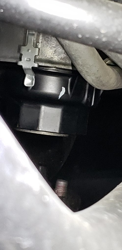

    19ft-lbs on the canister will put you right about here (metal tab to canister tab relationship). I don't even torque it anymore, knowing around where it needs to end up. It's the oring that seals, not the tightness of the threads.

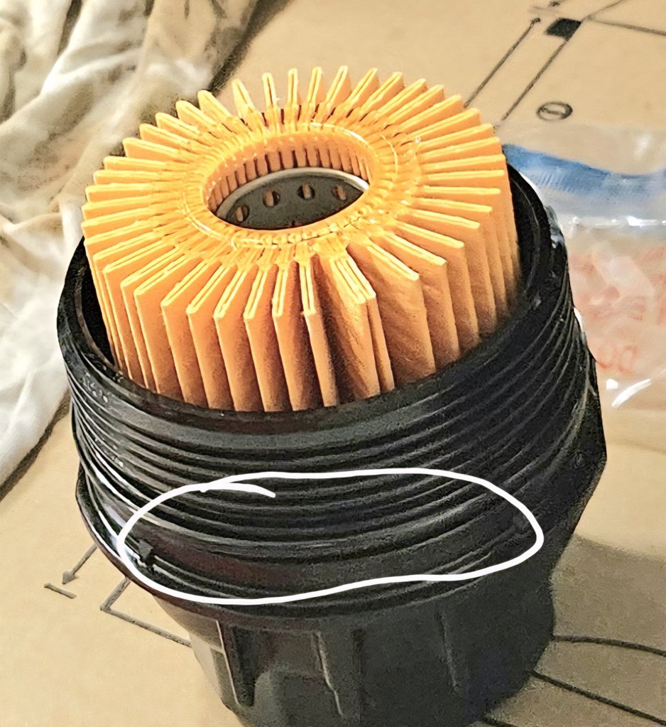

    Here's also a zoomed in image of where the large canister oring goes.

    rubber o-rings come with new filter. Be careful to put the big one in the correct slot... I havent changed the drain crush washer ever.. Zero to 1/2 ugga duggas for the filter
