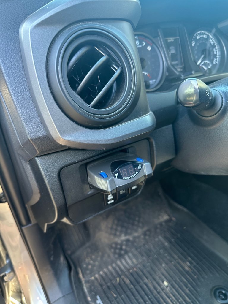

    on a Teknosha prodigy or similar- I like the ability to 'boost' the trailer brake- it has saved my a few times to control a trailer that started swaying.
    While you can definitely do that with the Redarc- its a rotary knob and you have to pay attention to how far you turn it back to maintain the original brake bias. I find the prodigy's spring loaded booster more intuitive and ergonomic.

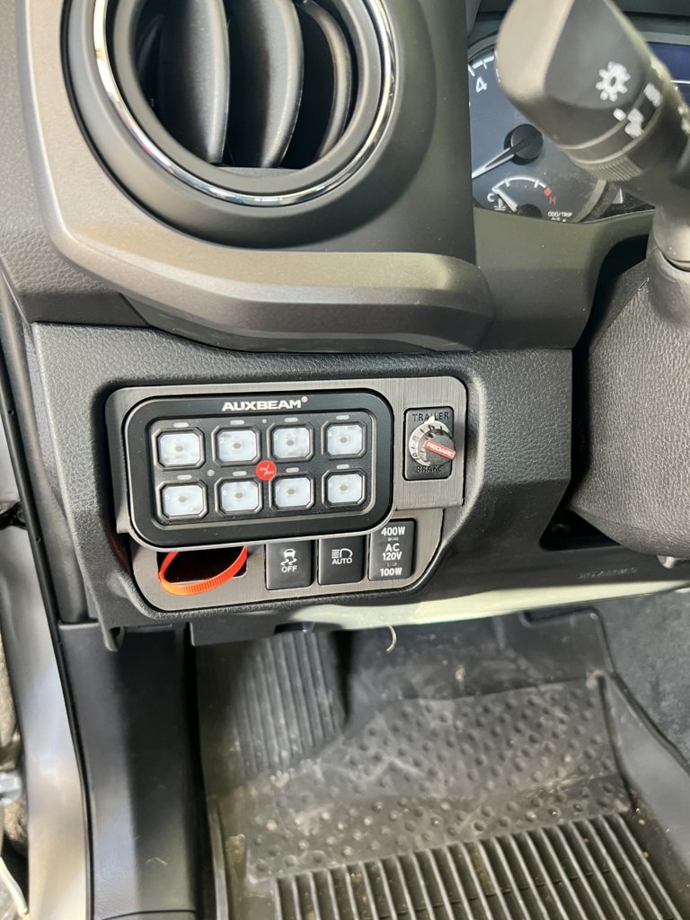

    Thank you much for timely and informative replies )) My '16 tacoma does have the factory tow package and after reviews, comments here and info from the OffRoad service shop here, I'll probably go with the Redarc, has a cleaner install on the tacoma, taking advantage of some empty plugs etc so no extra wires showing or needed anywhere. The rotary dial will fit into that empty plug slot at lower left of dash next to 120v back bed switch for a nice factory look also.

    I have the Redarc Liberty and got a custom laser cut panel off Etsy to mount it nicely under the dash. I think the Etsy seller might be on this forum actually. Anyway, it’s a nice clean set up and I don’t have to stare at some huge brake controller mounted by my knees.
