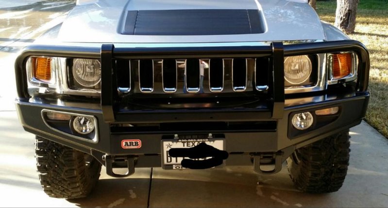

    That is one huge plus to the one for the H3. They used the factory recovery points. I just put one on my wife's H3 after she smacked a deer in Dec and jacked up the factory bumper. I wish the taco version had these or something like them.
    BTW, ARB actually made the bumper to come down over that area, so you just re-install the rp points over it.
