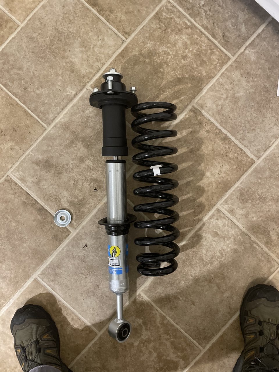

    I have just bought ARB Old Man Emu 2885 springs and Bilstien 5100’s. My question is on spring compression. I have about 4” of spring compression and it looks like a bit to much. I’m wondering if maybe I have revived either the wrong springs or shocks. I have the 06 Taco 4wd v6 off road. Also I am planning to lift the front 2.5” and one inch in the rear to lift and level with spacers. I am not by any means a Taco expert and I am looking for any advice you guys would have for me.87DCA7AF-5A2D-4367-9AF3-927EB11DBCC9.jpg

    The coil mounting perch is upside down in your photo.
