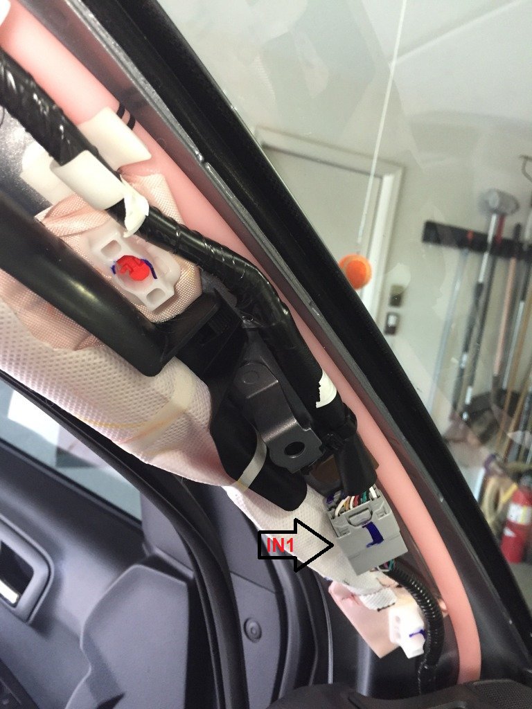

    IN1 is behind the Driver's sail panel.

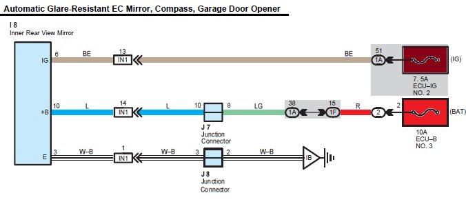

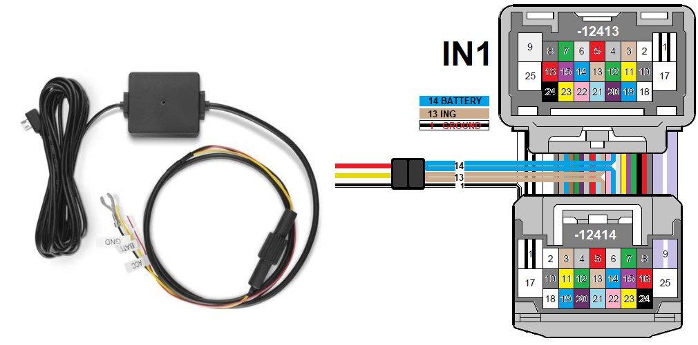

    @kmorgan3 could assemble and sell you the harness.
