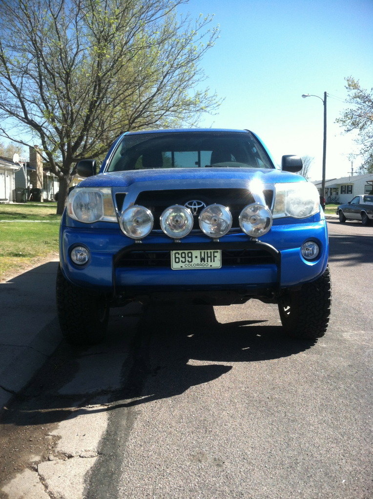

    I have 4 PIAA 80 racing series off road lights. They were originally on my 97' Tacoma and were purchased and installed new on it in 1997. 15 years later and the bulb just went out on one after countless hours of use which also includes several all night off roading trips in my old truck and them being used for several hours straight on my 07' as well. I absolutely love these off road lights and will be buying more or the ones like them soon that are just high beam only. These have bot ha low and high beam so they are very versatile or if I am following someone off roading, I can switch to low beams and not blind them.

    ^^^^^^^^ what light bar is that man?

    That is a Randy Ellis light bar. I bought it in 2007 shortly after buying my truck. It was not all that expensive either and has been great. Very easy to install too. I think maybe 4 bolts on each side and everything mounts up to stock locations so no holes need to be drilled.
