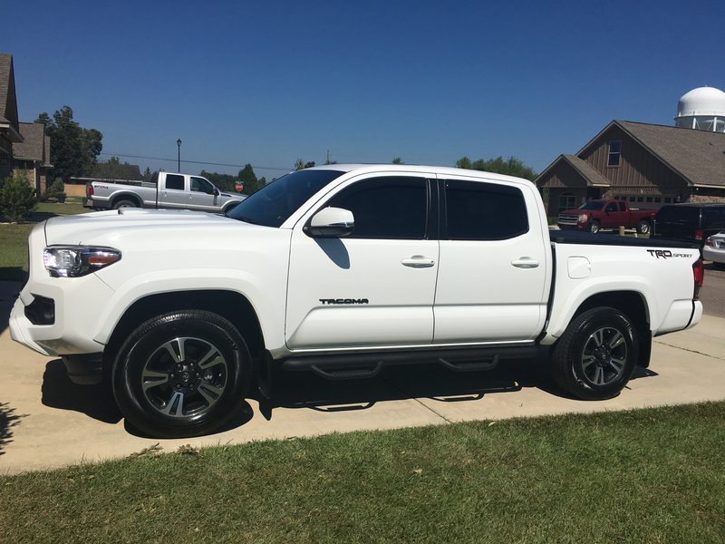

    20160305_140608.jpg 20160305_140618.jpg Its really easy no worries at all and it will last a long time .Just make sure you follow directions and put plenty of coats on.20160305_170159.jpg
