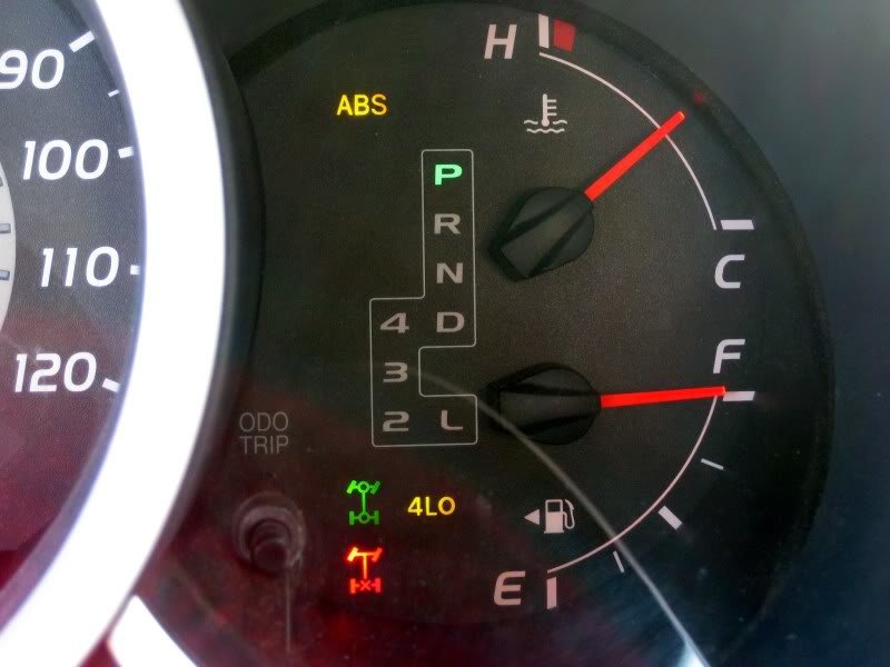

    Remember, the flashing rear locker light will stop flashing when the rear is locked...

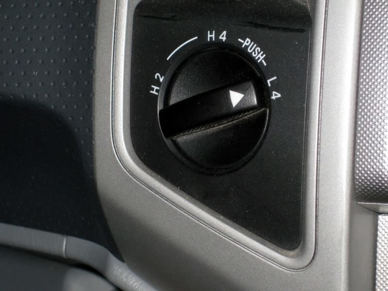

    STEP ONE: Read the warning (mainly to know that once you are through the difficult place to turn off the locker):
    STEP TWO: Engage Low Range:
    STEP THREE: Push the Rear Locker Switch:
    STEP FOUR: Check and see if light is flashing or solid, if flashing repeat steps, try rolling truck, etc.:
