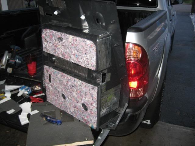

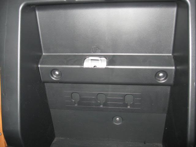

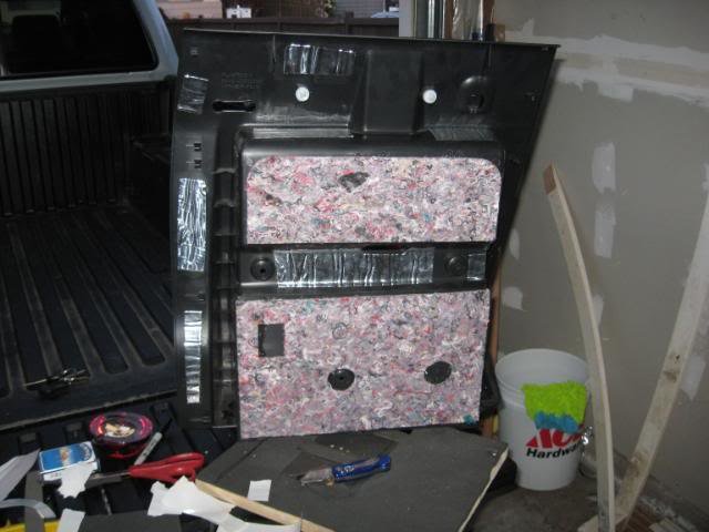

    Here are some pics of my 06 plastic bin.
    These pics are from me re-installing it.. Not sure if they'll help, but just to give you more of a visual.. Tug that bastard straight out !
    3 bolts
    Looks like 4 push in tabs.. 2 white ones on the top.. 2 black ones on the bottom, I think..IMG_0573_6ecbea9c4b75ab300c8facd088c0d5c70835078c.jpg

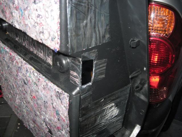

    Rear Side view
    In addition to the push in pin things, the edges have plastic male parts that snap into stuff too. But they look like straight out pulls, not up.
    On the driver side edge, I know there are clips that snap into the pillar, you'll see that once you get it off :)
