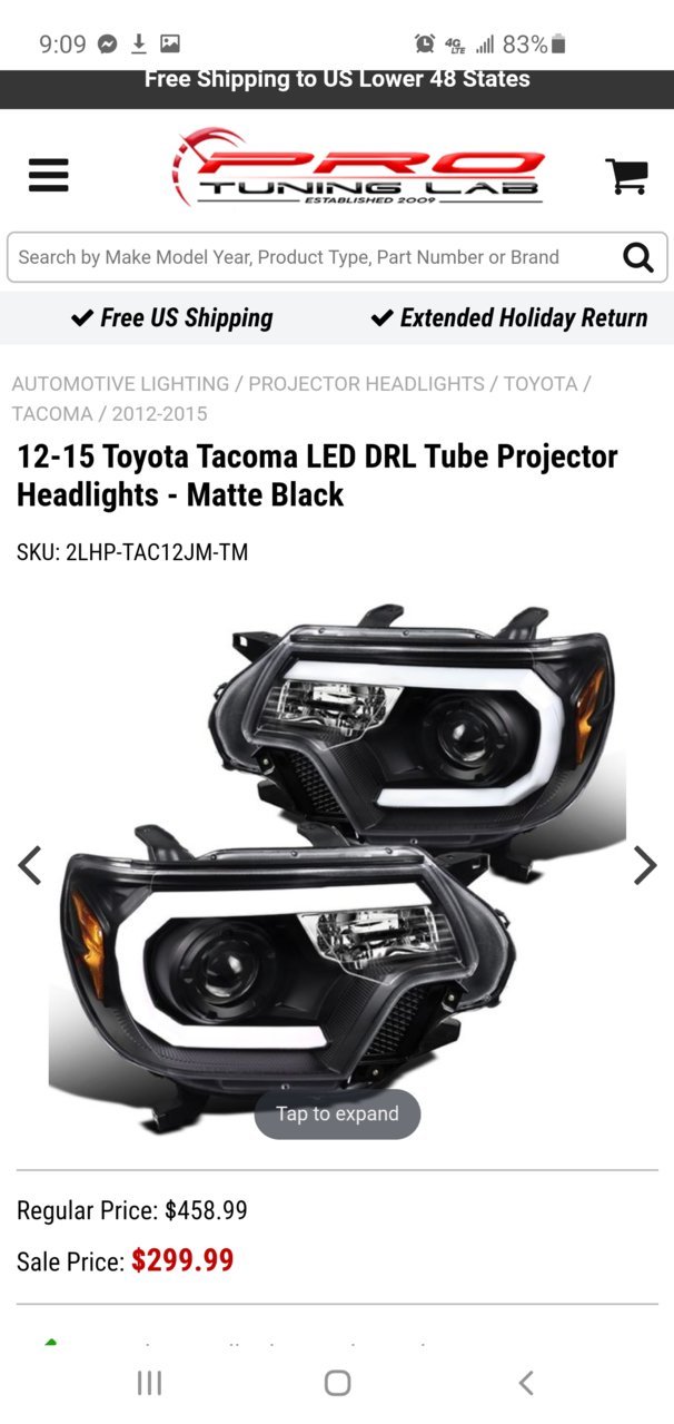

    I was looking these to replace my stock headlights... there projector but use halogen bulbs and just curious if worth it... better then the stock refelctor...

    You’ll have better light output from the stock housings with halogen bulbs usually.

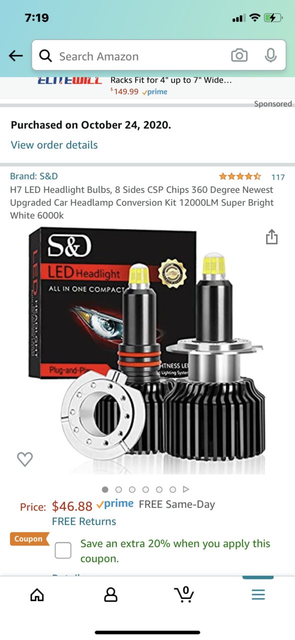

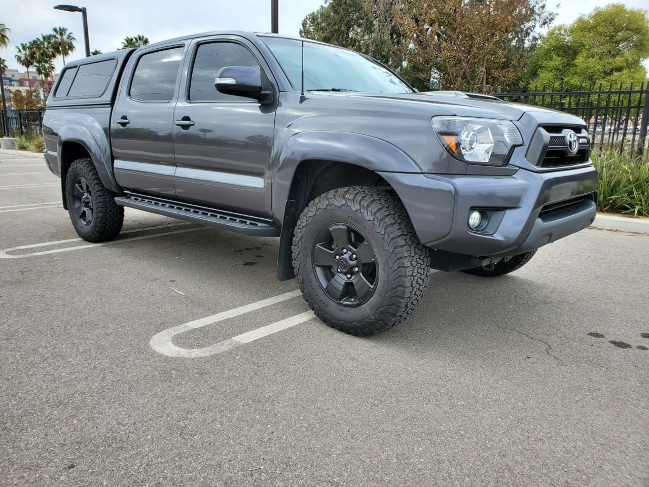

    I have the same headlights but I replaced the bulbs with these ones for brightness. They have worked well so far. Definite improvement on cut off and glaring over HIDs in the oem headlight. No complaints on brightness after the bulb swap. You have to use the LED tipped bulbs if you do decide to swap the bulbs.

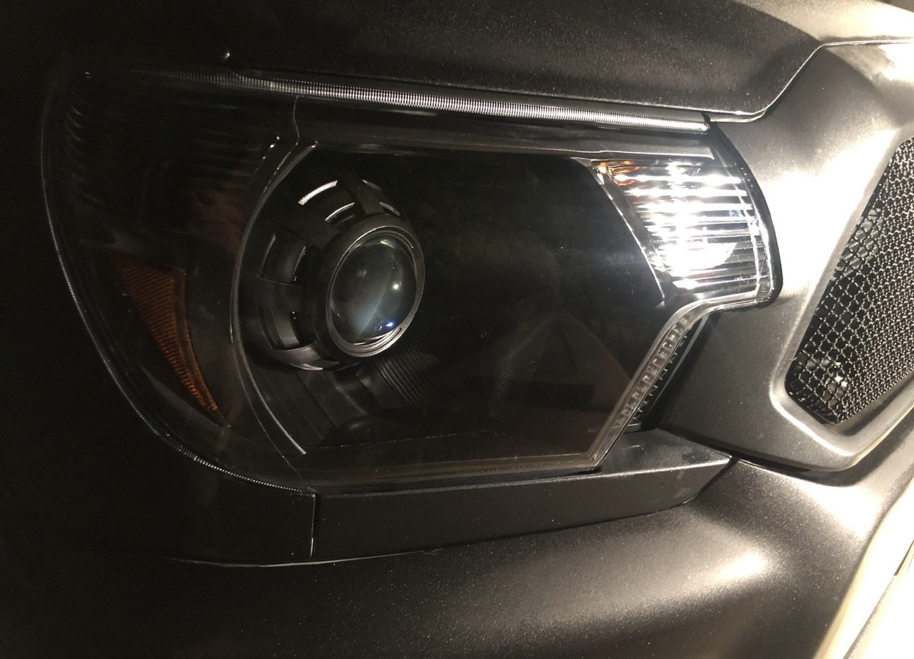

    Did the Morimoto HID retrofit on my 2012. ~$350 for the kit. Lighting is amaze-balls!

    BI-LED retrofit projectors. No start up lag and light for dayyyss. Although I do like the look of some of the newer lights being offered but from what I’ve read here, the lighting is dismal.

    Projectors can improve your lighting, but you get what you pay for. Cheap projectors - which is most of them - are pretty dismal. If you really want to do projectors right, you pretty much have to go with a custom retrofit through somebody who knows what they're doing.
    As for LED bulbs, lord help me. 99% of what's out there is crap - with awesome marketing. (That includes the one's mentioned above.) Generally speaking, LED bulbs will decrease your performance in projectors. In housings designed for halogens, all you'll do is glare the hell out of oncoming drivers. Don't be that guy.

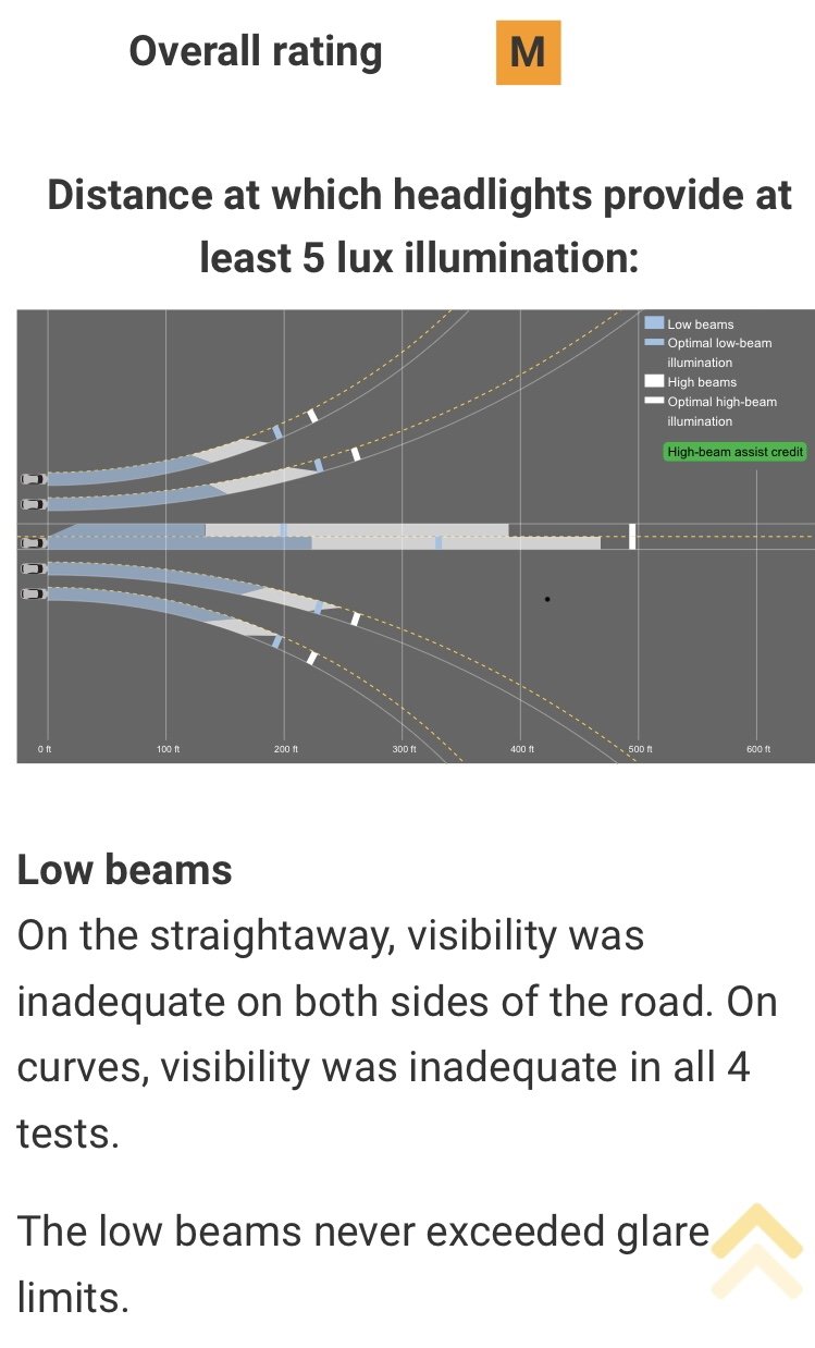

    I thought my Tacoma projector low beams gave me terrible light, IIHS ratings were poor as well. I replaced my oem H11 bulbs with Tungsram +130 bulbs and they are much better now. If I had reflectors I sure wouldn’t replace with projector headlights, my old 2007 Colorado with reflector lenses were far better.

    Yeah I’m a reader and contributor at times on that thread. That’s how I ended up with the GE/Tungrsram +130 bulbs to improve my 3rd gen OEM projectors. Wouldn’t consider any aftermarket unless testing was against the headlights I have. And cost ;) So no, I wouldn’t trade reflectors like in the 2nd gen for any projectors. IIHS ratings for 3rd gen Tacoma halogens (low beam projectors):

    No wiring involved, unplug stock then plug them into new ones
