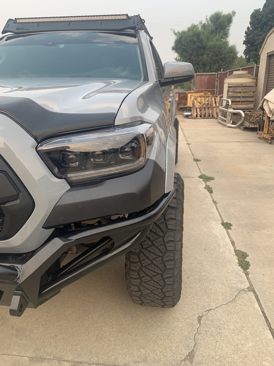

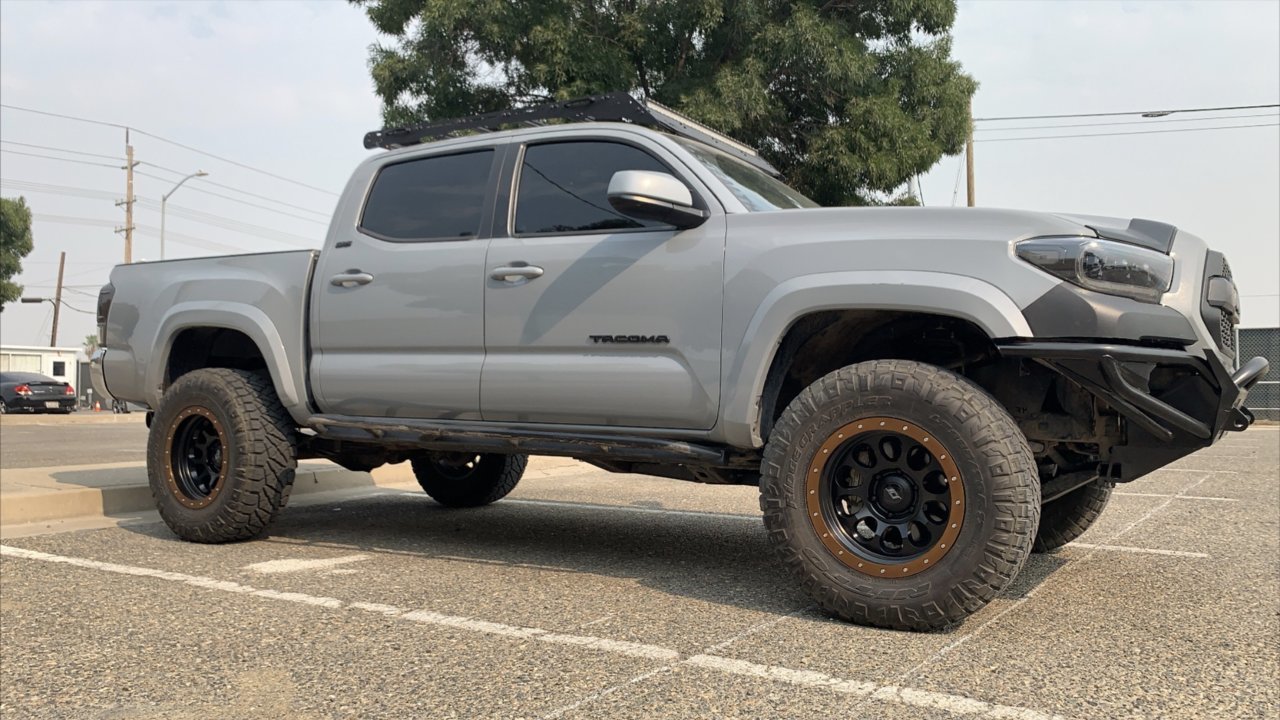

    My rear end is a bit higher than a TRD PRO setup, but i’m running 17x9 with a -38 offset currently. I have the OME 2.5 inch lift kit (with the weight I have on the front end, it’s comparable to stock.
    Each truck is slightly different but you will rub.
    I don’t think I needed a CMC for these, but definitely inner fender liner needs to be slightly trimmed.
    I’m upgrading to 35s anyways so I’ll be doing a lot of cutting soon.
