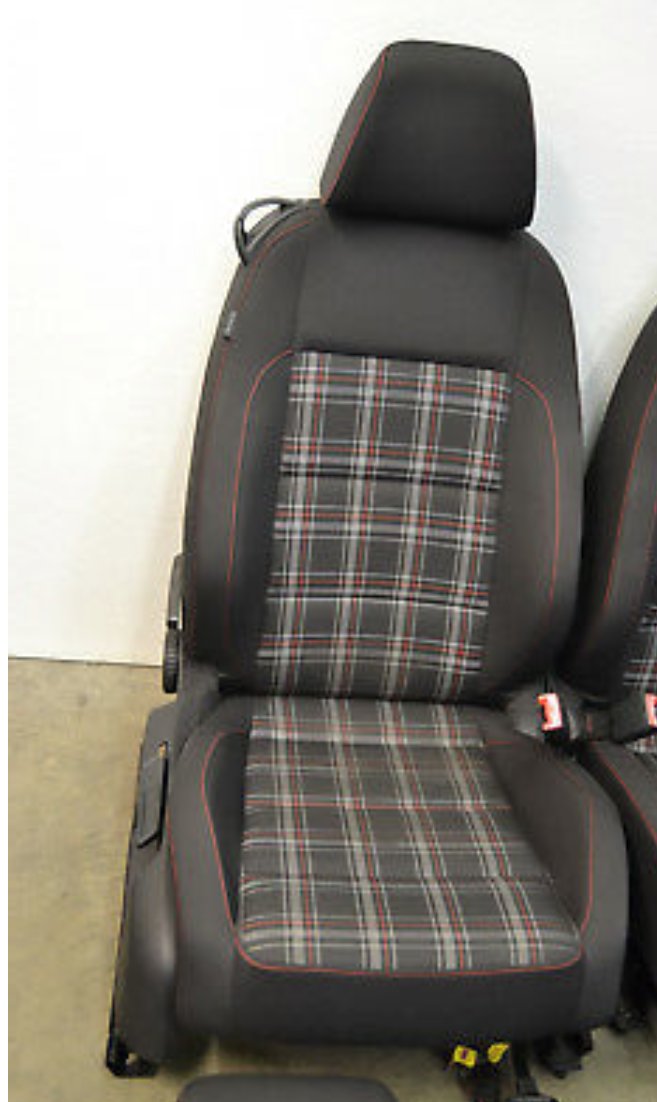

    Mainly for the novelty of having GTI seats in my truck lol... I would eventually try to get the cloth on the door armrest to match the black cloth in the seat.
    Photo attached

    Looks good. Height/size might be an issue with fitment or adjustments. Definitely take the old seat and put the new one in roughly before any drilling
