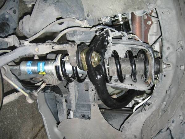

    This isn't stock but does it look like this one?
    I think you are talking about the uca. In that case you shouldn't rub with 265's but it's easily fixed with 1/4" spacers that go behind the rim. I haven't researched them but you may need to also buy longer studs so you have enough thread to be safe.
