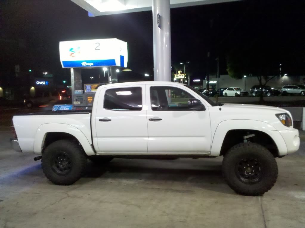

    Spindles although pricy, are, in my opinion the route to go.
    They maintain factory specification and geometry as well as they allow for self install. I am not knocking any of the 6 in kits here, but I wanted to do all my own work and the thought of cutting cross members and not having any welding experience...
    Plus I save money for other gear.
    But all and all it's 6 and one half a dozen another...
    However, with the 5100s on front, I do have a bit of adjustability if I need to go higher which I am. About the 1.78 level like GTACO's settings on his billies.
    I had to do some miner cutting for 295s they come out to be about a 34... on the richter scale

    nice.. thanks!

    I know when I go up in the front I will have to go a inch in the back.
    I have a iCon AAL (3) pack and that brought it up with the sag for the stock crappy oem toyota pack and for the most part it sits level...
    But I will have to raise it some more.
    God I love the white and black rigs...
