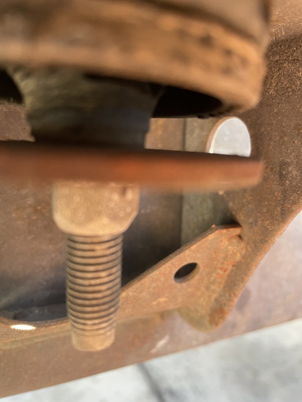

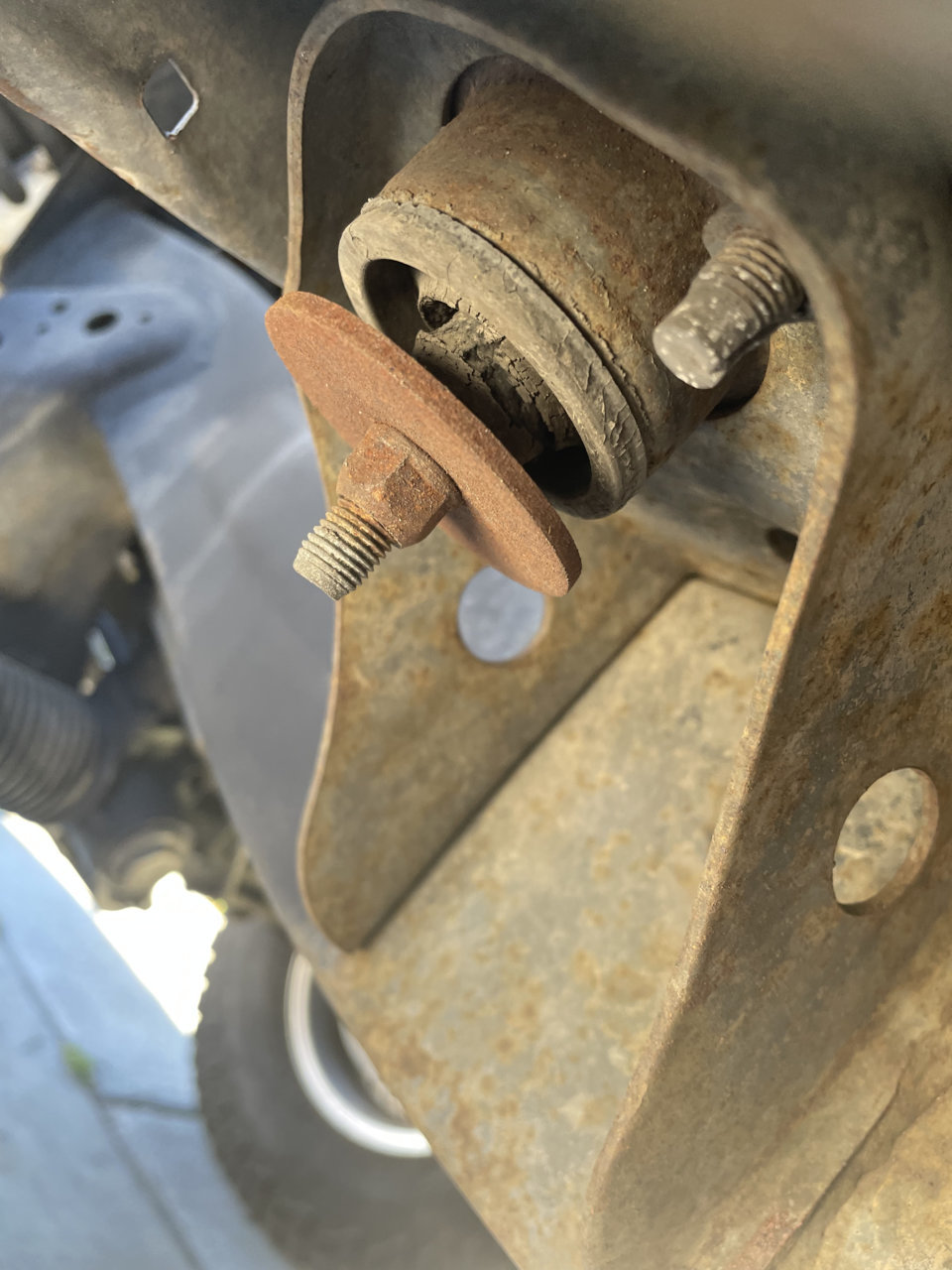

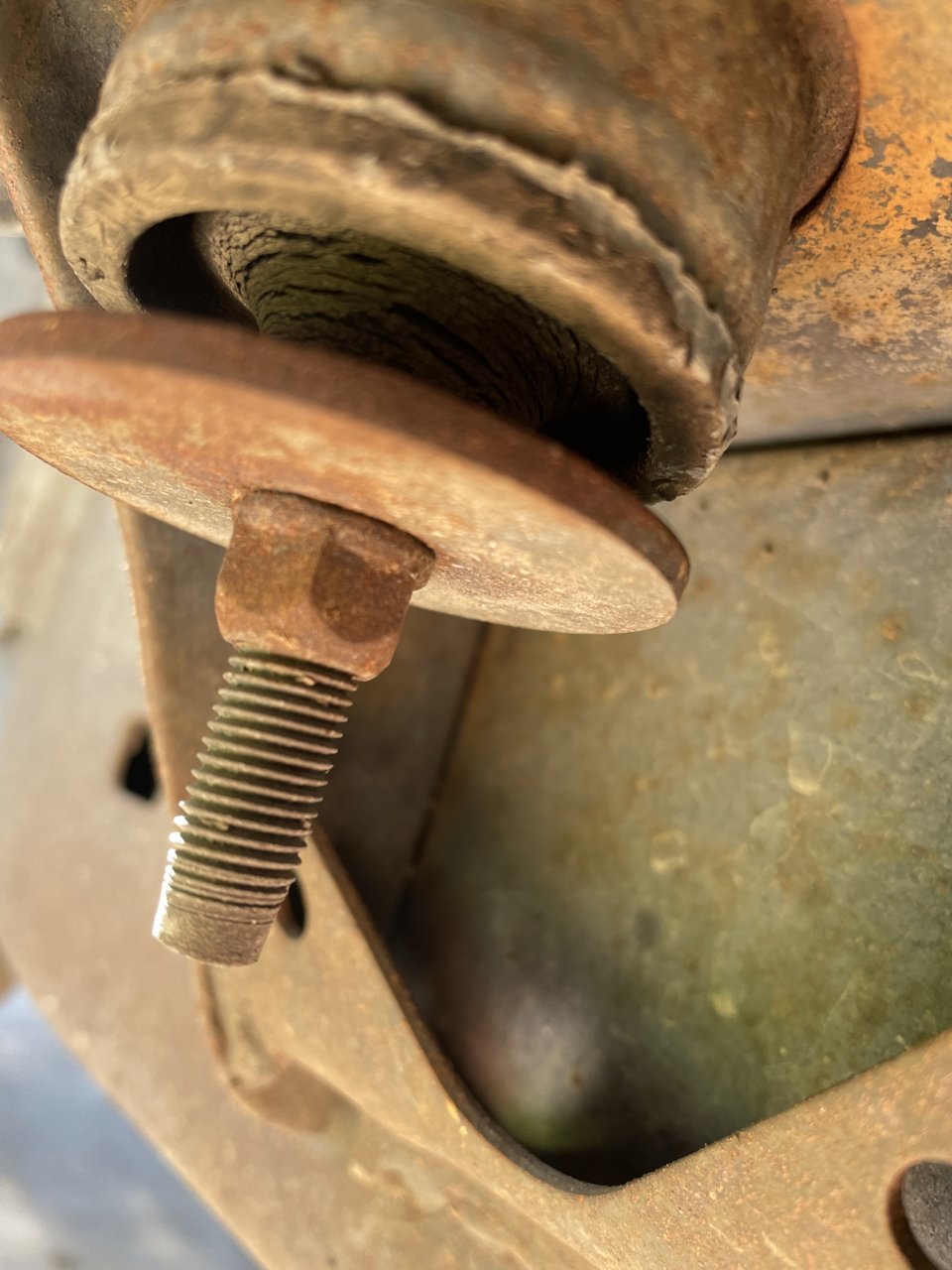

    Are these OEM body mounts? Is having that much space normal? Are these body spacers? Wanting to replace them. TIA

    Yep, those are factory

    And yes that space is normal, it allows the body to go up slightly think of it kinda like suspension for your cab off the frame reduces noise vibration and harshness.
    That said they are toast time to replace them, I recommend the Energy Suspension body mount kit and doing the body mount flip along with the oversized core support mounts.

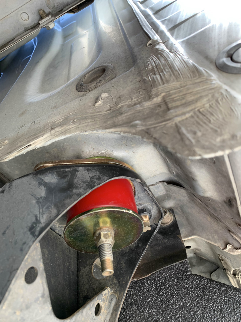

    Your typical body lift is 2"+, 3/8- 1/2" is barely noticeable, I have my mounts flipped and you'ed never be able to tell based on bumper gaps or whatever unless you were looking for it.

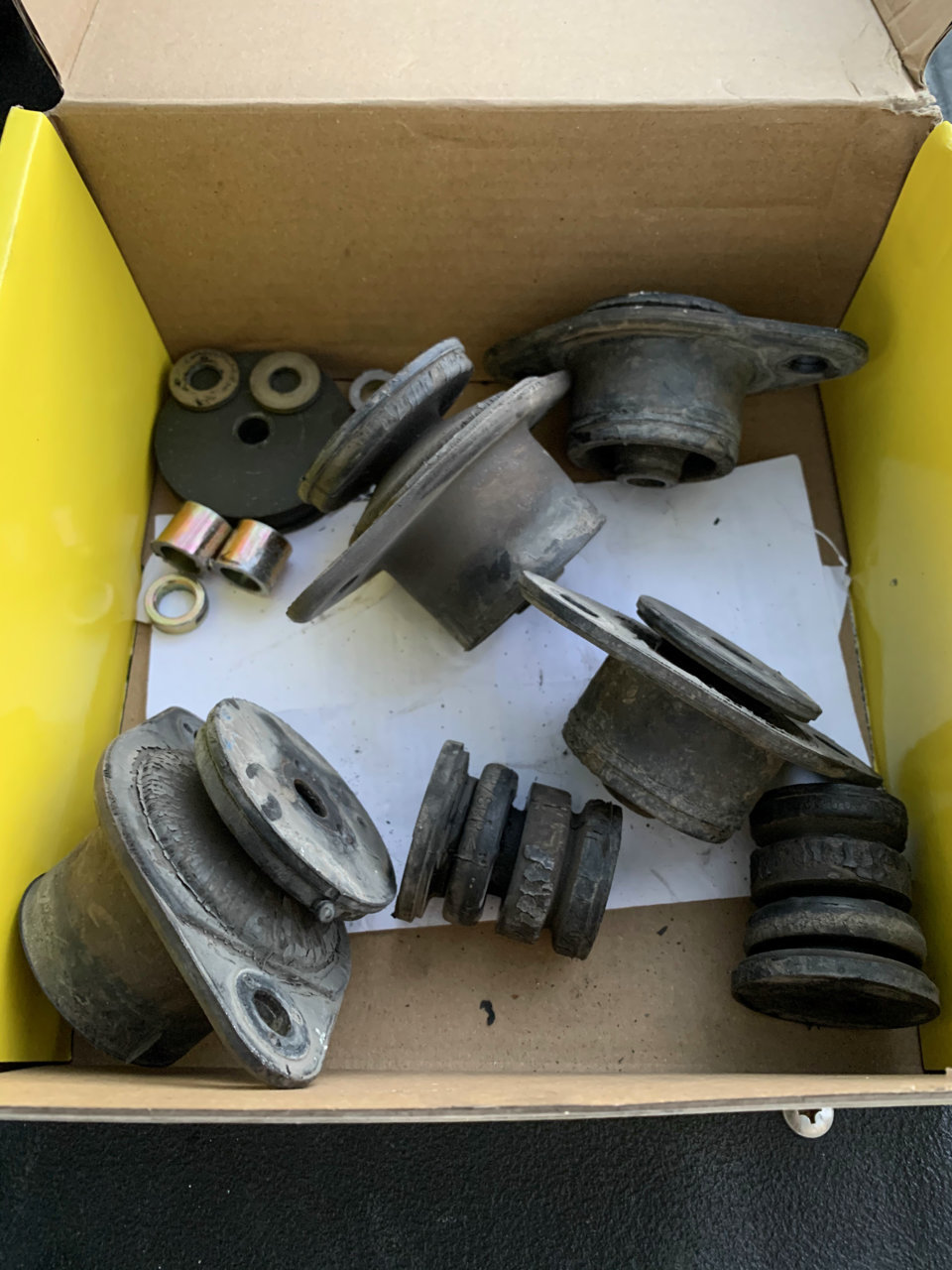

    My old mounts on my drivers side were 7/16 more more crushed than my passengers side when I measured and installed the poly mounts, the front left core support and front left body mounts were completely collapsed to the point where the bonded top washer was making contact with the steel of the mounts.
    Polyurethane is made in many different durometers for their applications, the ES Poly body mount bushings are slightly more firm than stock but softer than suspension bushings. It's not like riding on hockey pucks or static mounted and flipping the mount give some more cushion as well.
