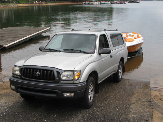

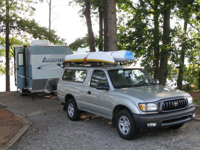

    Tow a 1400lb (dry) Camplite TT with 200lbs of gear in the camper & about 400lbs of camping gear/Leer Shell/Kayaks in the back of the pickup, with a 2WD Tacoma 2.4L/5 speed. Have found I can only use 5th on level ground & downhill with the camper with best fuel economy of 16 to 17MPG @ 55MPH, so far. Use 4th mostly & stay under 60MPH in 4th.
    Can tow a 1900 to 2000lb boat @ 65MPH in 5th getting 20MPG on the interstate and only had to shift to 4th on long mountain grades, so far.
    The aerodynamic drag with the TT is much greater than the low profile boat, with total load hauled being about the same.
    Thought about buying a new 4.6L Tundra, but decided to continue towing the TT with the Tacoma and slowing down to 55MPH or less for better fuel economy. Have a Scangauge on order to monitor and find the best speed/RPM combination for fuel economy when towing the TT. The Tundra would handle the TT easily, but I would probably get the same or higher fuel burn with the Tundra.

    Have electric brakes on the CampLite TT with controller in cab and no brakes on the boat trailer. The Tacoma handles both easily with good stopping power.
