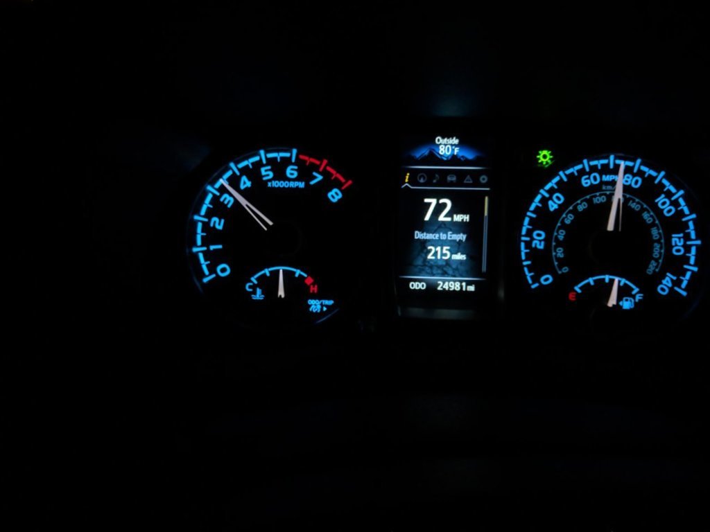

    Yip. Haha. And it'll tow fine. It's a smaller engine so it works a bit harder. But that's why the paddle shift is nice. You can select the gear which makes the work easier for the truck. And that's all the truck cares about, not mpg. Don't be afraid of high rpms either. This is a 4th gear pull and I'm barely into the power for these trucks. Attkinson's go high.
    Good luck and welcome aboard
