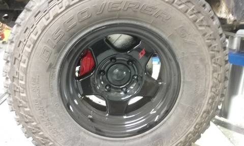

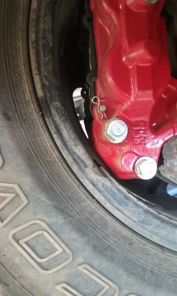

    285/75R16 SCS f5 with tundra brakes it solved my rubbing issues on the frame and control arms but it still rubs the pinch weld area when turned and stuffed.
