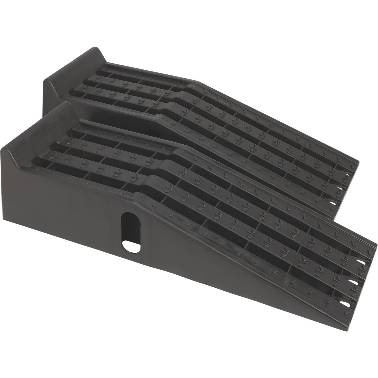

    Howdy! Recently I acquired a 2018 TRD Off Road, and love it. I'm planning on doing the oil changes on it myself and had a question. As a kid I remember helping my dad change the oil on a 78 Chevelle. He used ramps that he would drive the front end up on, then we'd go at it. So my question/questions are...
    1. Is this a good idea to use on a truck or any vehicle, because since you're at an angle you won't be able to drain all the old oil. (Dad and I lived on a hill, so the driveway had a slight angle, and we changed the oil with the car facing downhill so it would be relatively level and somewhat safe.)
    2. Are lifting it and putting it on 4 jack stands a better option so you're still level? If so what/where are the jack points? Definitely don't want to mess up my truck trying to service it. Also not killing myself would be a plus.
    3. What are your opinions on using pneumatic oil pumps like these? (https://www.amazon.com/s?k=fluid+pump+oil+change&ref=nb_sb_noss_2) Seems like more of a hassle to me, in my opinion.
    4. Combination of ramp and pump?
    Thanks for your thoughts, opinions, and help.

    unless you are fat you should be able to squeeze yourself under the truck no lift needed
    i use ramps on my wifes civic

    I use ramps. Wayyyy easier.

    The problem with those ramps is that the truck isn't going to be level and all of the old oil will not drain out. I changed my own oil from the 1970's until a few months ago. When dad built his home in 1972 he used railroad cross ties to build a place in the back yard you could drive onto and get under cars easily.
    After dad died mom moved out the house was sold. I was able to do it on trucks in my yard easy enough. I just paid to have the Honda done. But my regular mechanic will change it for $10 if I provide the oil and filter. For $10 I've just let him do it the last few times.

    I back into the driveway and onto the ramp. Pretty close to level for me and my driveway

    Kind of a personal preference really on the ramps. I can see why some people like them, even though the Tacoma is high enough already you don't need them. It's nice having extra space to move around. Think of them more as a luxury than a necessity...
    Me, I don't use them.

    The oil change is simple enough do without the ramps; but, trying to get the darn skid plate back on with limited space under the truck is a pain. Lifting the front on the ramps after the oil change is done would make it much easier.

    Measure the amount of oil drains into the pan, I think you will get 95% of the oil.

    The amount of oil that doesn't come out if you have the truck on ramps is absolutely negligible. It will have zero impact on the life of the truck. If it makes it easier for you to put it on ramps do it. Trust me. 4oz of old oil not coming out won't mean jack shit to the truck when it holds over 6 qts. These trucks run incredibly clean. Just use an OEM oil filter and it will filter out more than adequately.

    Just get ramps if it helps you get under the truck. Forget the pump. Isn't necessary.
