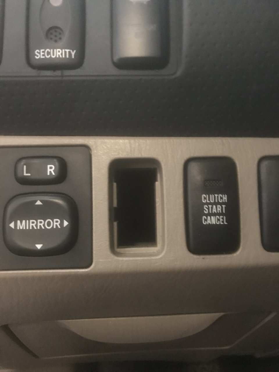

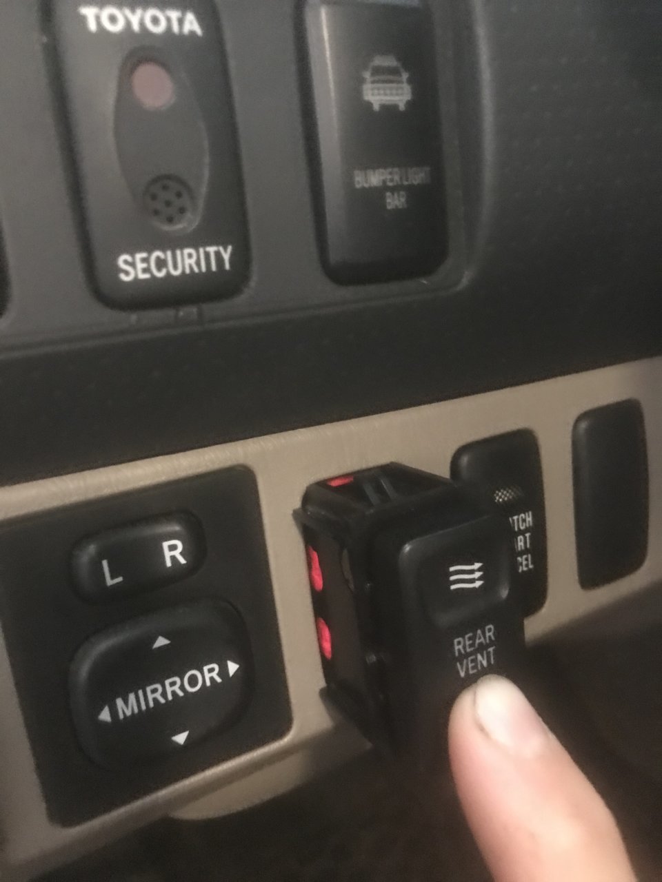

    25089419-BAEB-49CF-B2F6-9B1B4BEEE420.jpg 497E3955-A61E-403C-BA24-F79A0DCDC80E.jpg Hello all,
    I’m in the process of completing the power rear wind mod on my 05’ Double Cab and I ordered an OEM switch for a 2004-2010 Sienna. The switch doesn’t even come close to fitting, it has a square profile where my truck has the more rounded switch profile. What Sienna switch drops in or do you guys mod the switch to fit?

    Well I’ve tried pushing it backwards from the front and I’ve tried pushing it forwards from the back. It does not appear to be even close to the same design as the switch slots in my dash. Just curious if anyone else out there has had to whittle the Sienna switch down to fit or if they are supposed to drop in? The button won’t even clear the hole.

    Is that part around the switch removable? Maybe it's not needed?

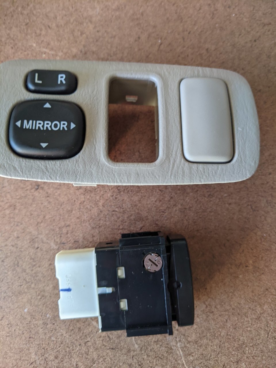

    Looks to me like the receptacle is a completely different design on the Sienna panel vs the Taco panel.91063508-3C8D-4F45-9F09-859255AA4A61.jpg

    Confirmed by at least one person via PM the Sienna switch is not plug and play, modification to the switch socket, and/or the switch are required for use on a Taco.

    This is correct. A little work with a dremel tool on the switch will allow it to fit. If you take too much off use tape to increase the size for a tight fit. I am using the sienna switch for my power rear window on an 09. My favorite mod by far.
