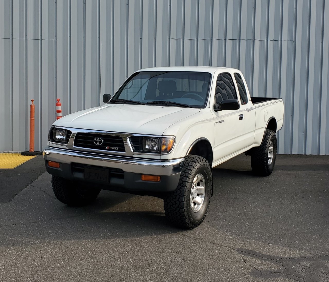

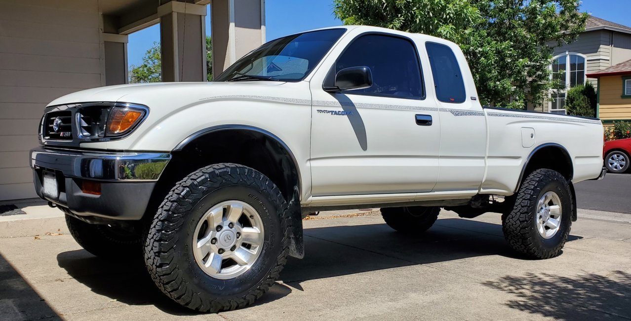

    20210724_113806 (2)_LI.jpg 20210814_082224_LI (4).jpg Yes, an alignment is always a given after you lift your truck.
    Here is how my truck turned out after the Quick Lifts and Wheelers Progressive AAL. I also got the Rancho RS9000 shocks for the rear to match the front struts.
