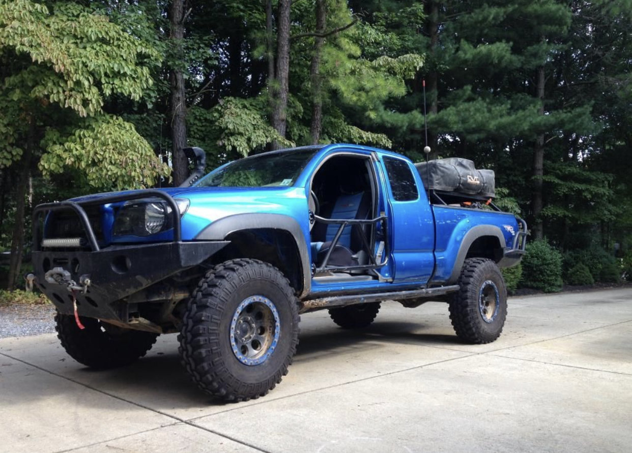

    I’ve got a set of the super swamper pizza cutters. They are a little loud but they last a long time and I like em. Work great off-road. They are lighter compared to other tires too, I may get another set when these finally do wear out.

    I had a set of Swampers on another truck and I really liked them. They are noisy, but handled as good as any mud tire on road. They did perform well in mud, although like any mud tire, you have to spin them to clear them. I will say this about all these mud tires though, the OP lives in Colorado and mud tires can be scary bad on ice or packed snow. If I ran any of these tires where winter conditions are prevalent, I would center sipe the tires with a razor siper. I spent 35 years in the PNW, and even though we had plenty of mud, I wouldn't run any of them without siping. People love the look of mud tires, but they don't look as cool on a truck that is upside down in the ditch.

    I've run Super Swampers before (albeit they were TSL grooved to a similar pattern as the TruXuS) and I still have a set stacked in the yard for crawler use. I would pass on them unless your truck is off-road only. They perform terribly in all forms of snow. There's a reason you rarely if ever see any interco tires on the road in CO.
