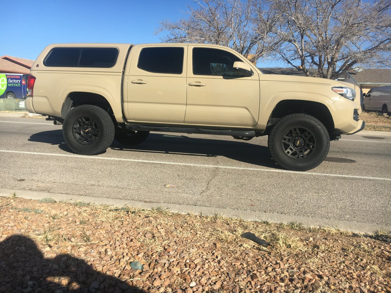

    I love my LEER. Agree with the comments. It all depends on how much you add. I’ve added a bunch of weight and I haven’t added any heavy duty springs. Just have fox 2.5 shocks, that’s before the shell. I also go off-roading with the thing.
    pdxtaco02 and KrnTaco08[OP] like this.

    Looks great!
    cruetes[QUOTED] likes this.

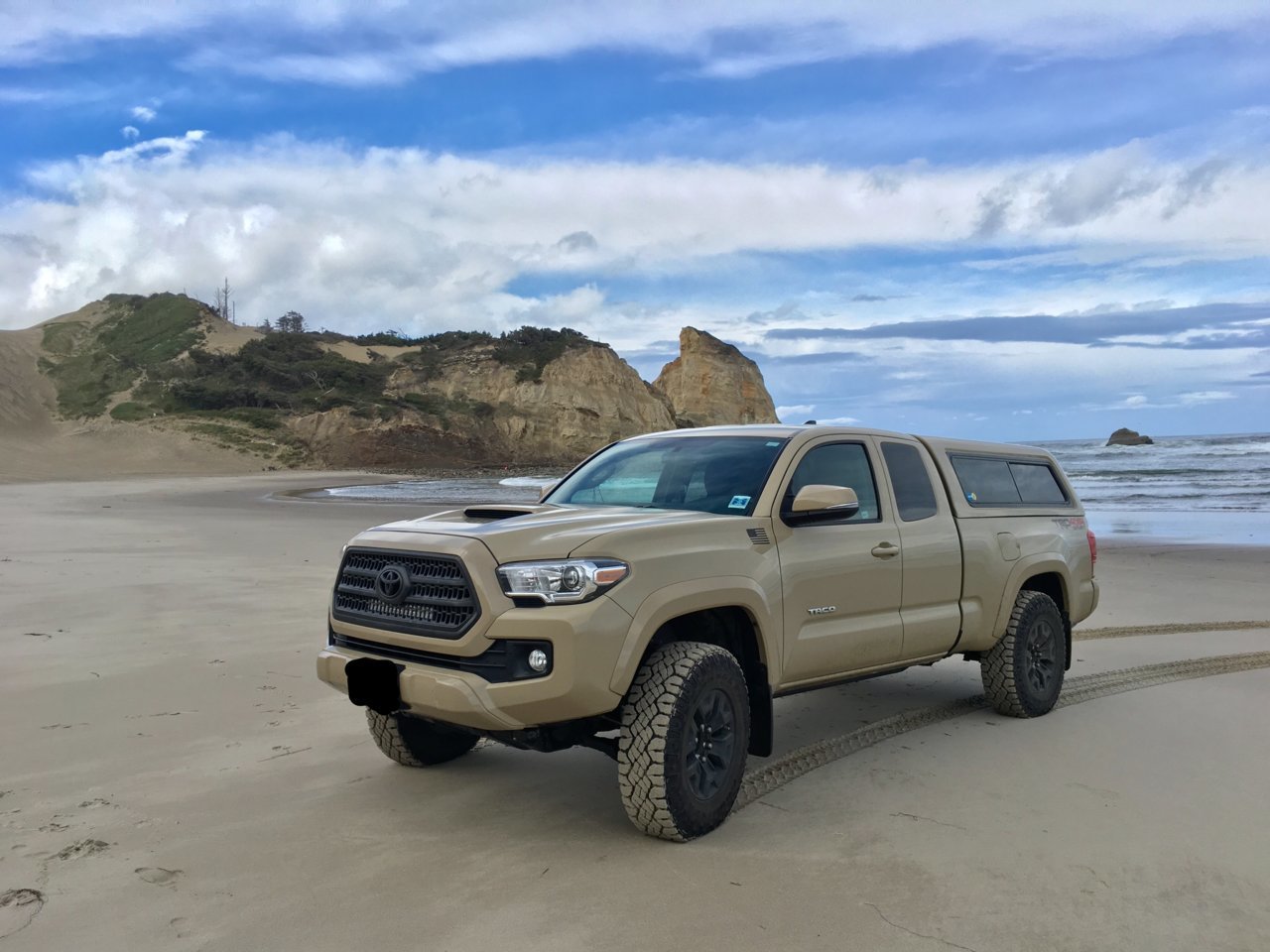

    Keep in mind most canopies (for tacomas) weigh about 140 lbs. So you can simulate that added weight by adding a few sandbags to your bed if you really want to test it.
    I had a ARE Canopy on my access cab (6 ft bed) and it weighed about 160. Also have stock OR shocks. I regularly added another 100-200 lbs of gear in the back for camping skiing ect and never had any squatting or load issues. I feel like if you went another 200lbs past that you'd want heavy duty springs.
    Most guys that just add a canopy don't need any suspension modifications. Keep in mind trucks are heavy up front and light in the rear, they're designed with the idea of hauling in mind.
    Hope this helps,
    Luke
